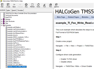

  • Yes, you can use the Flash API. but it doesn't solve your problem: remove the flag (0x5a5a5a5a).
    You may consider to use FEE driver to program the flag to EEPROM (bank 7). The HALCoGen generates FEE driver for bank 7 which is used as EEPROM.
    The HALCoGen help includes an example for using FEE driver:
    FEE user guide is located in HALCogen installation folder.

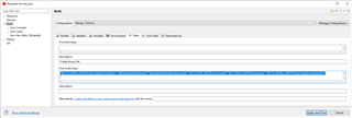

  • I am sending ethernet bootloader project which doesn't work with static or global variables.
    In the BOOTLOADER_STATICS_DOESNT_WORK.rar which was attached I think there is a typo in the boot loader code for the application start address.
    In the test_proj\source\HL_sys_link.cmd application the start address of the VECTORS section for the application is 0x00200020
    Whereas the Build-LAUNCHXL2-TMS570LC43x\Boot\bl_config.h has:
    // The starting address of the application.  This must be a multiple of 32K(sector size)
    // bytes (making it aligned to a page boundary), and can not be 0 (the first sector is
    // boot loader).
    // The flash image of the boot loader must not be larger than this value.
    #define APP_START_ADDRESS       0x0020020
    //0x8
    // The address to store the update status of the application image
    // It contains Application Start Address, Application Image Size, etc
    #define APP_STATUS_ADDRESS       0x0020000   /* This is must the starting address of one of flash sectors */
    What this means is that the boot loader is placing the application in a different address in flash to the address the application was linked for.
    ARM instructions can encode addresses as relative to the address of the instruction, so some code can still execute when loaded as a different address. However, the start up code to initialise static variables requires the code to loaded at the address the application was linked for.
    Having changed bl_config.h to the following:
    // boot loader).
    #define APP_START_ADDRESS       0x00200020

    To get a correct bin file generated in the CCS Project Properties:
    1. Disable the Arm Hex Utility
    2. Under Build -> Steps create a post-build step containing:
    "${CCE_INSTALL_ROOT}/utils/tiobj2bin/tiobj2bin" "${BuildArtifactFileName}" "${BuildArtifactFileBaseName}.bin" "${CG_TOOL_ROOT}/bin/armofd" "${CG_TOOL_ROOT}/bin/armhex" "${CCE_INSTALL_ROOT}/utils/tiobj2bin/mkhex4bin"
    With the above change:
    1. The generated test_proj.bin was now the expected size of 17,596 bytes
    2. Once the boot loader had flashed test_proj.bin the application successfully started (as shown by LED3 lighting)
    3. After the boot loader has flashed test_proj.bin then the CCS debugger could successfully verify the test_proj.out file in flash, where as previously when armhex was used to create the bin file the verification failed.
