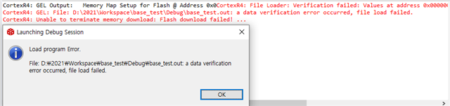

My customer built their custom HW using RM44L520 and 10 pin ARM JTAG connector and faced below errors when they download it using CCS.
They can download only symbols through CCS, and there is no issue to download FW using J-Flash.
'CortexR4: GEL Output:  Memory Map Setup for Flash @ Address 0x0CortexR4: File Loader: Verification failed: Values at address 0x00000000 do not match Please verify target memory and memory map.
CortexR4: GEL: File: D:\2021\Workspace\base_test\Debug\base_test.out: a data verification error occurred, file load failed.
CortexR4: Unable to terminate memory download: Flash download failed! .../
Could you please let me know what should be checked to download FW using CCS?

  • They can download only symbols through CCS, and there is no issue to download FW using J-Flash.
    So you can download the *.out file to the target flash without any issue using J-Flash, right? Is J-Flash Segger J-link emulator? I am not sure if the J-Link is supported by CCS.
  • Hi QJ,
    Yes. They can download the *.out file to the target flash without any issue using J-Flash and J-Link emulator. It looks J-Flash is a flash download tool from Segger.  They has used same J-Link emulator to connect CCS to their previous HW(same HW, but only differences are 20pin JTAG pin and RM46L852 used in their previous HW). As they success to download their FW using J-Flash, it seems there is no issue in their 10pin ARM JTAG pin. right? Is there any other thing to check?
    Thanks and Best Regards,
    SI.
  • Hi SL,
    I am not familiar with J-Link emulator. Do they use the same version CCS and same version J-Link driver for their new RM46x board? It seems to me that there is no problem with the RM46x board.
  • Hi QJ,
    Thanks for your response. I requested them to try it using TI JTAG.
    In the meantime, could you please check if there is any issue in below HW schematic for 10pin JTAG?
    SI.
  • The nTRST and nWRST should not be connected together.
    I don't how to control the nTRST using your adaptor.
