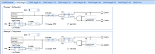

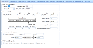

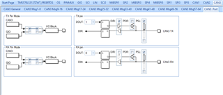

I wanted to send data via CAN1 CAN2 and CAN3 pins on Hercules Launchpad. I can send data from CAN1 and CAN2 pins properly with the "canTransmit()" command. But I could not observe the data I wanted to send over CAN3 pins with the logic analyzer. Is there a specific reason for this?
I can observe the data I want to send with the logic analyzer through the J2(DCAN1) and J3(DCAN2) terminal blocks on the Launchpad. At the same time, I read the data I want to send over the CAN1 and CAN2 pins on the J11 connector with the logic analyzer.
But when I wanted to send data over the "CAN3TX" pin on the J11 connector, I was not successful.
