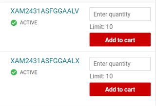

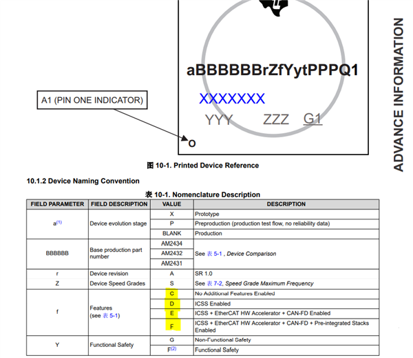

① I noticed that Table 5.1 in the datasheet shows that AM2431 only support 'C' and 'D'(in Figure 1), but in ti.com I found the product's name is "XAM2431ASFGGAALX". It seems that AM2431 can support 'F'. So I want to confirm to you whether AM2431 support 'F'?

  • Hi Julia,
    1. The "D" and "C" will not support EtherCat stack. "E" supports EtherCat only, while "F" supports all 4 Industrial Communication Stacks including EtherCat.
    2. EtherCat slave does need ICSSG and EtherCat Accelerator, therefore "E" or "F" is needed

  • Hi Ming,
    Thank you for your reply! But I still wanna know whether AM2431 supports "F". Let us return to question 1. In the description of the datasheet, AM2341 only supports "C" and "D", but according to the name "XAM2431ASFGGAALX" in Figure 2 and the naming rules in Figure 1, AM2431 can support "F". My question means that the description of the datasheet and the product name of "XAM2431ASFGGAALX" seem to have different definitions of whether it supports "F".

  • Hi Julia,
    I have confirmed it internally that the AM2431 does not support "E" nor "F", therefore it does not support EtherCAT. The EtherCAT HW accelerator is not enabled for AM2431.
    "XAM2431ASFGGAALX" you see when order AM2431 is a mistake. It should be fixed soon.
    Ming
