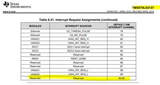

    I am trying the VIM RAM option. The VIM RAM address range is 0xFFF82000 to 0xFFF82FFF. 96 interrupt channels occupy addresses up to 0xFFF8217D.
    The remaining addresses is what I am trying to use but they are not writable. Can addresses above 0xFFF8217D be used or are they protected/used for something else?

    But the idea was was not to use the VIM RAM area reserved for 96 interrupt channels, rather use the region after it (between 0xFFF8217D to 0xFFF82400).
    I observe that we cannot write in the region 0xFFF8217D to 0xFFF82400. Is this region reserved for something else?

    The reason I suggested VIM RAM was because if you run PBIST for SRAM in your startup the SRAM can be wiped although that is also true for VIM RAM if you enable PBIST to run memory test on VIM RAM.
  • I should also say that I was testing on another device TMS570LS1224 as I don't have TMS570LS3137 with me at the moment. TMS570LS1224 has VIM RAM that can support 128 channels while TMS570LS3137 only has VIM RAM to support 96 channels. This is the reason beyond 96 channels, there is no physical memory. But you should still be able to write the last few locations of VIM RAM as they are not used.
