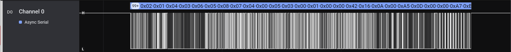

I am currently working on a project where I will be needing to stream data from an IWR1642 EVM to a TM4C123GXL over UART. Up to this point, I have tapped the AR_MSS_LOGGER pin on the 1642 and have confirmed with a logic analyzer that the data stream from this pin is at least similar to what I'm receiving thru a USB connection to my PC:
Logic Analyzer:
EVM to PC (USB):

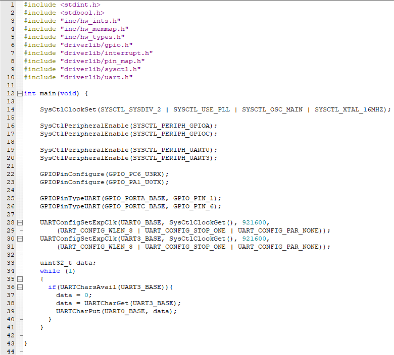

My TM4C Code:

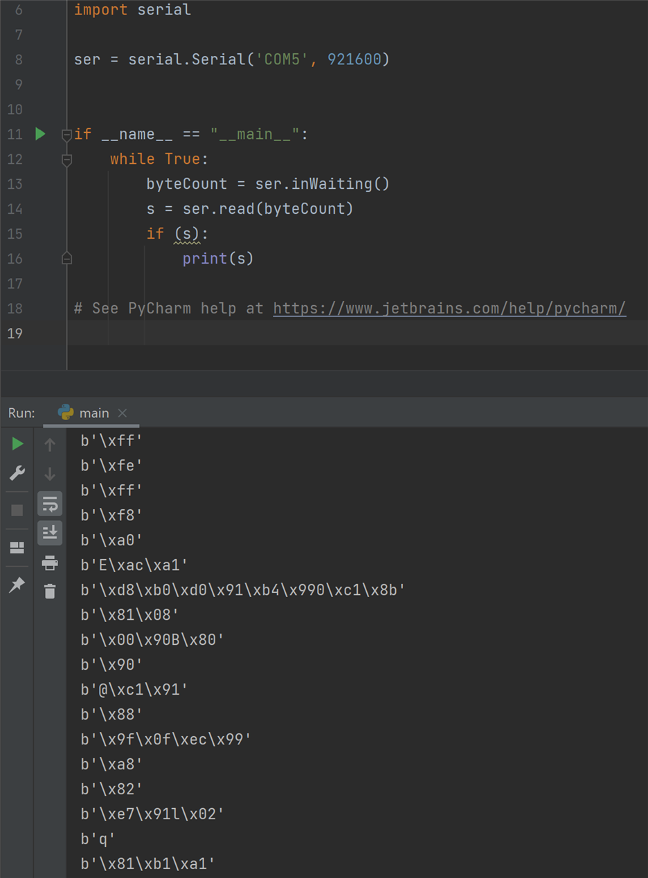

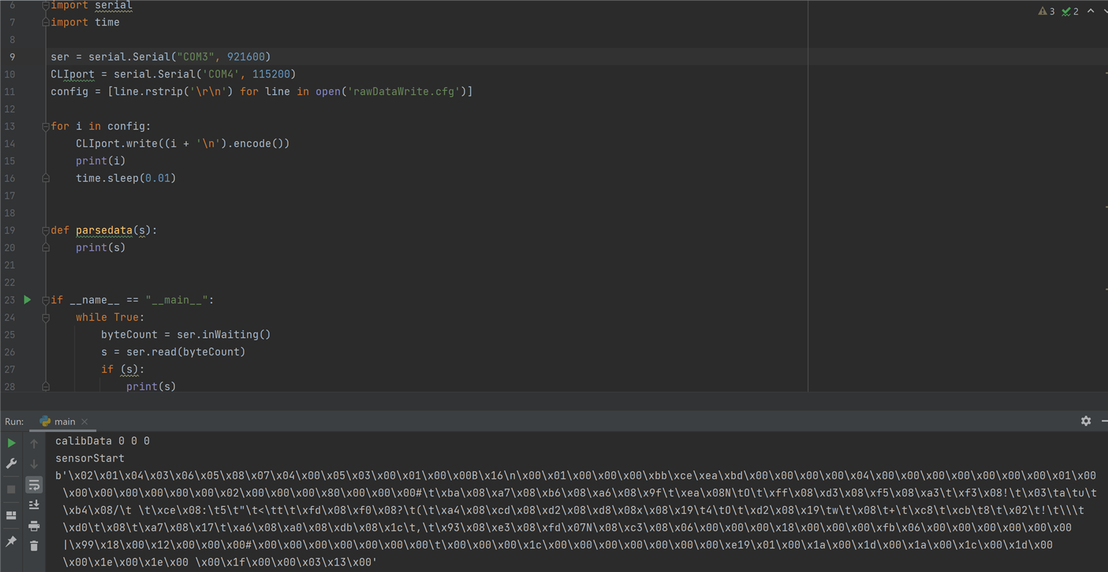

What I'm trying to do currently is get the data to stream from the EVM to the TM4C then to my PC to verify the data and begin to implement my parsing algorithm. The issue that I'm having is that I'm expecting my data to be in the format of the EVM to PC image. However, when trying to read the data from the TM4C I am neither getting the proper data nor format.
EVM to TM4C to PC:
I'm assuming I'm overflowing the buffer but am not completely sure. If anybody could give me advice on where I'm going wrong I would greatly appreciate it.

  • HI,
      I'm not familiar with IWR1642. I have couple of comments.
      - Do you have the same baudrate, stop bits, and parity bit setup the same between IWR and TM4C? If any of them is not matching then it will not work.
      - The function UARTCharPut() takes unsigned char as the second parameter. You call UARTCharPut() by passing a 32-bit unsigned parameter. Can you cast it to unsigned char and see if that makes a difference?
      - What did you actually read on the variable "data"? Can you show what is read by TM4C?
      - Can you configure both IWR and TM4C to a slower baudrate (115200)? I wanted to know if the baudrate has any impact on the outcome.

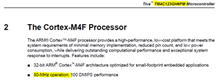

    Glad that your original issue is resolved. Please be aware that TM4C123 can only operate at maximum of 80Mhz. 100Mhz certainly will not work as it is out of spec.

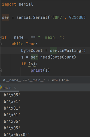

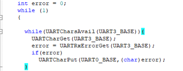

  • After a few experiments, I found that the error I get from using UARTRxErrorGet is returning 0x05. Which I don't believe is the Overrun Error, but if I'm not mistaken it's a Break and Framing error? Is this correct?
      I almost never see a break/frame error from any customers. Not really sure why you are getting it. Try to use UARTBusy , UARTCharGet and UARTCharPut instead of using UARTCharGetNonBlocking(). The non-blocking is mostly used with DMA. Also refer to the two examples in C:\ti\TivaWare_C_Series-2.2.0.295\examples\peripherals\uart.
  • Unfortunately, I believe those are the errors I'm receiving.
    I am using this code to see what my error is without debugging, which I've read is the reason I'm getting the overrun error. In this case, I'm not getting the overrun error, instead, I'm getting the break and framing error.
  • I really don't know why the frame/break error. You are receiving data from IWR. You really need to examine on a scope if the waveform is correct or not. As I suggested before, run at a slower baud rate. What is the result? Also can the logic analyzer show the waveform when IWR is sending to the MCU?
