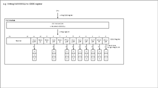

    Is our understanding correct about operating of high-integrity bits below?
    1) Processing of Write to high-integrity bits
    High-integrity bits is configured each 3-bit, and each bit is same value(1 or 0).

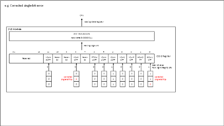

    2) Processing of Read when occurred single-bit error
    As a following figure of GCLK1OFF and VCLK3OFF, high-integrity bits is read correct value if one bit of 3-bits is flipping.

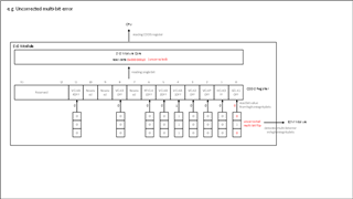

    3) Processing of read when occurred multi-bit error
    As a following figure of GCLK1OFF, high-integrity bits is read incorrect value if two bits of 3-bits is flipping, and ESM of "Register soft error" is generated.
    If our understanding is correct, how is Register Soft Error detected when flapped two bits of 3-bits?

  • Hi Sho,
    Helpful diagrams. You are correct. Thanks

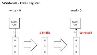

    We have a question about flipped bit of high-integrity bits.
    To notify ESM of 'Register soft error', these modules should detect to flipped 2bit of high-integrity bits.
    Could you please tell me about detection method of flipped 2bits?
    The following example expect GCLK1OFF of CDDIS register read the value of zero.
    Case 1) flipped 1bit, write = 0, read = 0
    Case 2) flipped 2bits, write = 1, read = 0
    Sho
  • Hi Sho-san,
    A single-bit flip within the “high-integrity bits” can be corrected, but two-bit or three-bit flips can not be corrected. In your example, the value of majority bits is 0, the return of read operation is 0.
    Your diagram is correct.

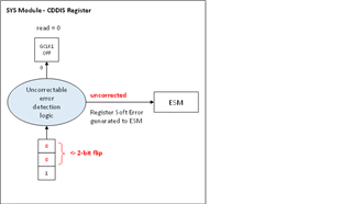

    (1) I created a diagram about the relationship between "high-integrity bits" and "ESM". Is this correct?
    (2) If this image is correct,please tell me the contents of "Uncorrectable error detection logic".
    (3) If this image is NOT correct,please tell me about the relationship between "high-integrity bits" and "ESM".
    Teruhisa
  • Hi Teruhisa,
    Your understanding is correct!
