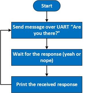

Hello team,

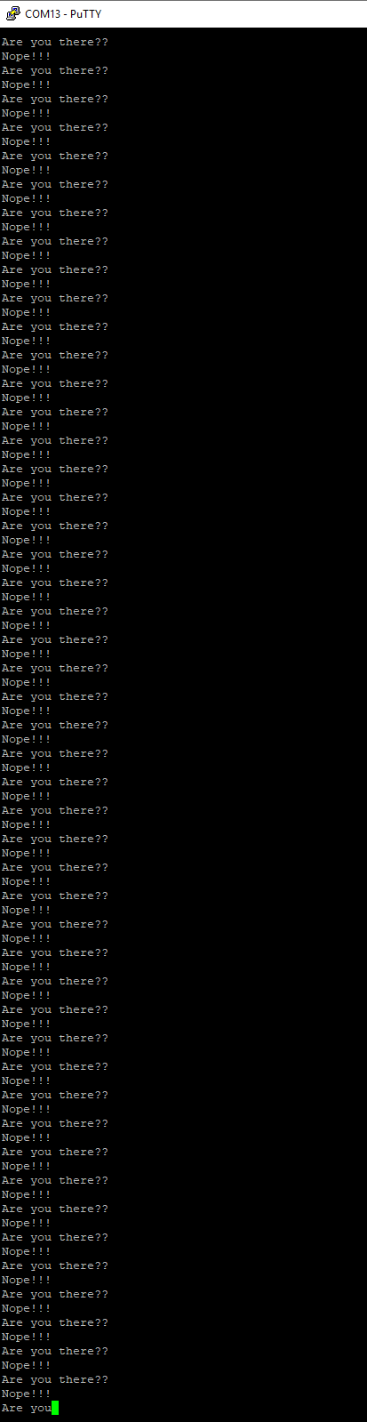

I want to transmit and receive message over SCI using Hercules Eval board (TMDX570LC43HDK). I’m able to transmit the required string through the code. However, I’m facing some issues with the received information. Picture below shows the flowchart of what exactly I want to achieve with the code. Also attached is the Terminal snapshot.
Below is my code snippet. Can you please help me with what I’ve been doing wrong?

    1. I suggest to use interrupt mode for SCI receive
    2. Does Terminal (Putty) have the same SCI settings?
    I don't see any instruction to increase the counter1, and don't think "char(counter1)" is correct.  --> the correct one is (char)(counter1++)
    Please try the SCI example code from HALCoGen help
  • Thanks for the prompt response Wang. I could make some progress on the same. Please find my code snippet below.

    I could use interrupt to receive the data. Progress made in line with my asked queries is as follows:
    1. I can now receive the data.
    2. using the received data, I can make required execution of commands.
    However, in line with my previous queries, I've been facing two issues:
    1. I still am not able to send the counter value over UART.
    2. I'm not able to receive and process the string input. for example, if you look at the code snippet provided, I can receive a single character and process the same (commented out in the code). however, while I define the integer pointer and use the sciReceive, I'm not able to proceed in the similar manner. Can you please look at it and share your thoughts? Basically I want to carry out the same thing as I mentioned in point 2 above, but instead of character, I want to use the strings.
