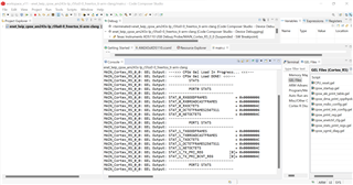

But i can not see ip adress or IP: 0.0.0.0 in 1-Gbps Full-Duplex mode as pic below.
sometime program run in down mode 100Mb. It always show IP address to me example: 192.168.1.12, and then i can ping to 191.168.1.12.
Can you guide me how to define or get IP address in 1-Gbps Full-Duplex mode.

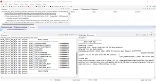

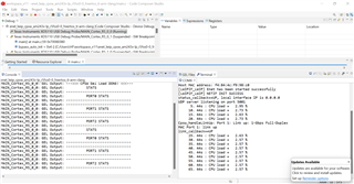

  • Hi Mr Prasad,
    Today i checked print state as your recommend.
    I receive 2 case test like below:

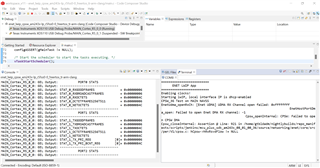

    1. If  port status return nothing. I always can run terminal and see Cpsw handle like PIC below and don't return IP
    2. If  ports return status info. I always see terminal console issue inform the same in all case test like that:
    ENET LWIP App
    Enabling clocks!
    Starting lwIP, local interface IP is dhcp-enabled
    CPSW_3G Test on MAIN NAVSS
    EnetUdma_openRxCh: [Enet UDMA] UDMA RX Channel open failed: 0xffffffff
    EnetHostPortDma_open: Failed to open Enet DMA RX channel: -1
    Cpsw_openInternal: CPSW: Failed to open CPSW DMA
    Cpsw_closeInternal: Assertion @ Line: 921 in /home/gtbldadm/nightlybuilds/repo_manifests/scripts/jenkins/mcu_plus_sdk_am243x_08_01_00_36/source/networking/enet/core/src/per/V1/cpsw.c: hCpsw->hRxRsvdFlow != NULL

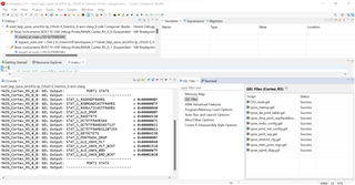

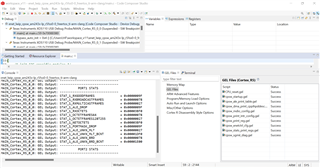

    And here is the PIC i capture:
    Return Port 0 and port 1 info:
    Only return port 1 info:
    --> Could you please give me some suggestion to do next?
    --> What different between ports return data and return no data?
    --> What and where i need to do to fix IP address config(ex: 192.168.1.12) in gigabit mode? Because some time i received address: 192.168.1.12 in 100Mb mode.

  • Hi Duong,
    Below error tells that the sysfw image is not latest or consistent with what the SDK version is using.
    Are you using SBL NULL mode or using gels to configure SOC?
    Can you please share your sysfw boot logs?
