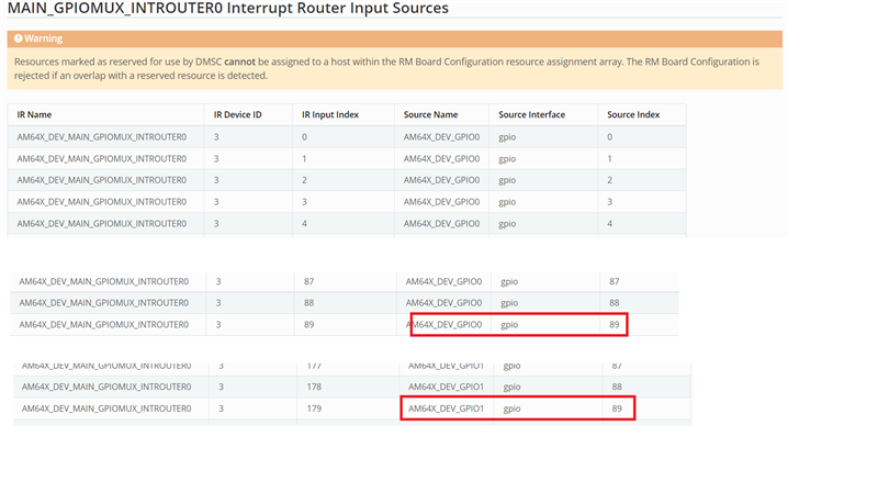

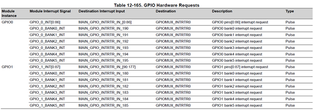

    I have question regarding to CPIOMUX0_INTROUTER0 setting in example: gpio_input_interrupt_am243x-lp_r5fss0-0_nortos_ti-arm-clang
In this example, we are using GPIO1_54 to trigger interrupt to R5FSS0_CORE0 through GPIOMUX_INTROUTER0_OUTP_8.
We using Sciclient_gpioIrqSet( ) to set interrupt router mux.
static void Sciclient_gpioIrqSet(void)
int32_t retVal;
struct tisci_msg_rm_irq_set_req rmIrqReq;
struct tisci_msg_rm_irq_set_resp rmIrqResp;
rmIrqReq.valid_params = 0U;
rmIrqReq.valid_params |= TISCI_MSG_VALUE_RM_DST_ID_VALID;
rmIrqReq.valid_params |= TISCI_MSG_VALUE_RM_DST_HOST_IRQ_VALID;
rmIrqReq.global_event = 0U;
rmIrqReq.src_id = TISCI_DEV_GPIO1;
rmIrqReq.src_index = TISCI_BANK_SRC_IDX_BASE_GPIO1 + GPIO_GET_BANK_INDEX(GPIO_PUSH_BUTTON_PIN);
rmIrqReq.dst_id = TISCI_DEV_R5FSS0_CORE0;
rmIrqReq.dst_host_irq = Board_getGpioButtonIntrNum();
rmIrqReq.ia_id = 0U;
rmIrqReq.vint = 0U;
rmIrqReq.vint_status_bit_index = 0U;
rmIrqReq.secondary_host = TISCI_MSG_VALUE_RM_UNUSED_SECONDARY_HOST;
retVal = Sciclient_rmIrqSet(&rmIrqReq, &rmIrqResp, SystemP_WAIT_FOREVER);
if(0 != retVal)
DebugP_log("[Error] Sciclient event config failed!!!\r\n");
DebugP_assert(FALSE);
return;
I have question about TISCI_BANK_SRC_IDX_BASE_GPIO1. In the code, we program it to 90U.
/** \brief bank interrupt source index base */
#define TISCI_BANK_SRC_IDX_BASE_GPIO0 (90U)
#define TISCI_BANK_SRC_IDX_BASE_GPIO1 (90U)
#define TISCI_BANK_SRC_IDX_BASE_MCU_GPIO0 (90U)
I'm wondering where is 90U coming from?
I checked TRM, I can not find answer.
Can you please help to clarify?  Thanks.
