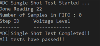

  • Doing that causes the output to display:
    and the code gets stuck from there. The next lines of code it isnt getting to is:
    DebugP_log("Step ID Voltage Level\r\n");
    DebugP_log("------- -------------\r\n");
    and the loop displaying it. Not sure why it gets hung up, possibly from the ISR.
  • Hi Dylan,
    What "Debug Log" you are using? "CCS Log" even the "UART Log" may be too slow for continuous  sampling mode. can you save the samples in memory and print out them later?
    Ming
  • Did a test to read X elements from the ISR before stopping the ADC so the DebugP_log (CCS Log / UART) messages are printed. It reached the ISR an amount of times, but the FIFO remained at 0
    Ok so I modified it as such:

  • Hi Dylan,
    Try the attached file. It works for me.
    Ming

  • Thanks, that does work for me too, so how would you recommend I access this data on a different core, because from this example, in order to truly continuously sample the ADC the while loop needs to be maintained indefinitely, so a different core would need to read the data asynchronously. Should I make the SRAM overlap and try to specify an exact point in the SRAM memory or is there a protocol for passing buffers from one core to the next?
  • Hi Dylan,
    This polling example just to prove the ADC continuous mode is working. The continuous mode should work for DMA or interrupt mode. By using the DMA or the interrupt mode, you do not need a another core for polling.
    If you decided to use the interrupt mode, then your ISR has to handle the the various interrupt events. Only sends the semaphore when it is ADC_INTR_SRC_END_OF_SEQUENCE.
    Ming
  • So basically I can use the DMA example with continuous mode, and since it has direct memory access I should not need to trigger ISR's or pauses in my code? I will try to implement this.
  • In udma adcread test, if I apply continuous transfer mode, it works for one run of the code but if I run it again it gives me "ASSERT: 0.53114s: ../udma_adc_read.c:App_create:275: UDMA_SOK == retVal failed !!!" I believe this could have to do with the buffer overflowing from continuous mode? Is there some additional settings to make the UDMA have a buffer that is. Here is where I am at so far which generates that error:
    It most consistently has this retVal error for the dequeue function "retVal = Udma_ringDequeueRaw(
    Udma_chGetCqRingHandle(rxChHandle), &pDesc);"
    There is probably a simple setting which makes the ring operate correctly but I am unfamiliar with the UDMA ring library.
