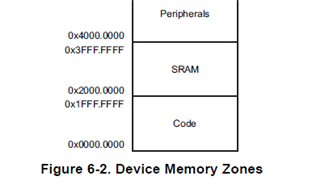

A quick and possible stupid question but is this correct? Should it not be 0x2000.0000 as per the offset defined in 6.4.1 of the datasheet?
#define PTR_SAFE_FOR_EMAC_DMA(ptr) (((uint32_t)(ptr) >= 0x2000000) &&   \
                                    ((uint32_t)(ptr) <  0x20070000))
