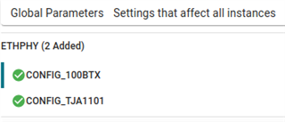

       I've got the problem: I did a misconfiguration of PHYs assignment
    Fullscreen
    1
    2
    icssEmacParams.ethphyHandle[0] = gEthPhyHandle[CONFIG_100BTX];
    icssEmacParams.ethphyHandle[1] = gEthPhyHandle[CONFIG_TJA1101];
    XXXXXXXXXXXXXXXXXXXXXXXXXXXXXXXXXXXXXXXXXXXXXXXXXX
    It depends how such macros are configured in syscfg, in my case:
    - CONFIG_100BTX = 0
    - CONFIG_TJA1101 = 1
    When it didn't work I had swapped the 2 phy, so not belonging to the right port of ICSSG
       Andrea
