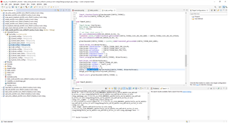

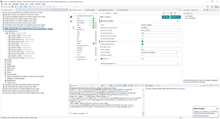

  • Hi Philip,
    Here is what I did:
    1. Imported the hello_world_am243x-evm_m4fss0-0_nortos_ti-arm-clang, then added a Timer using the SysConfig (example.syscfg):
    2. After build the project, open the generated file ti_dpl_config.c, the TimerP_init has the HwiP_Params_init and HwiP_construct for set up the HWI for the MCU Timer 0:
    Ming

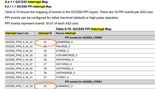

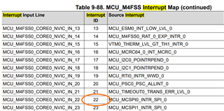

  • Hello Ming,
    it seems there was a bit of confusion on my part.
    What I really want to know is the destination interrupt controller before having an HwiP_object.
    What I am still not understanding is where the information of the destination interrupt controller comes in at all.
    For instance looking at the interrupt maps in the TRM, let's look at for instance IRQ number 22 (just a random number):
    So to configure an interrupt, I have the following parameters:
    Assuming I want to have an interrupt configuration for all the above interrupts with IRQ number 22 from the TRM,
    and I want to set a different ISR for each one of them,
    how would I know which ISR would be set to which one of them?
    I cannot see any parameter where I actually tell the HwiP what destination interrupt controller I am aiming for.
    And the intNum alone is ambigous (it is 22 for all the above cases).
    Thank you for your help, and sorry for the confusion.
    Best regards
    Philip.
