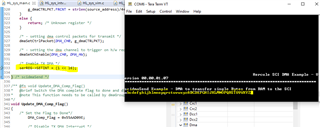

  • The BTCA interrupt was due to the sci_printf() call, which uses sciSend(), that happened after the call to _enable_IRQ().  It happened whether I used 31 or 29.  The original code was meant to use sciREG1 to display test status while testing linREG1 (scilinREG), so it was fine.  I moved the sci_printf() before scidmaInit(), to alleviate the problem.  I was under the impression that sciSend() could be used even after scidmaInit() and _enable_IRQ() have been called, but that's probably not right.
    I was hoping 29 or 31 would now work, but that's not the case and the behavior after scidmaSend() remains the same.  It's as if scidmaSend() has some issue with actually kicking off the DMA, as the display string doesn't show up (unlike in the prior situation with sci_printf()/sciSend() sending its string out (and causing the BTCA interrupt)).  I step through the scidmaSend() code and it looks fine; I really can't see anything I can change in it to fix the problem.
    Thanks.
    sci_printf("scidmaSend Example - DMA to transfer single Bytes from RAM to the SCI\n\r");
    /* Init serREG for DMA transfers */
    scidmaInit(serREG); /* Requires sciInit to be called first */
    /* Enable CPU Interrupts */
    _enable_IRQ();
    // sci_printf("scidmaSend Example - DMA to transfer single Bytes from RAM to the SCI\n\r");
    scidmaSend(buffer);
    /* Enter Code Here but do not call scidmaSend again */
    /* Wait for the DMA interrupt ISR to set the Flag */
    while(DMA_Comp_Flag != 0x55AAD09E){
    IDLECOUNT++;
    /* scidmaSend is complete and can be called again */
    sci_printf("\n\r\n\r");
  • I would have expected these last lines in scidmaSend() to have kicked off the DMA and displayed the test string (with serREG == sciREG1).  But, I see nothing on the terminal.
    /* - setting dma control packets for transmit */
    dmaSetCtrlPacket(DMA_CH0, g_dmaCTRLPKT);
    /* - setting the dma channel to trigger on h/w request */
    dmaSetChEnable(DMA_CH0, DMA_HW);
    /* Enable TX DMA */
    serREG->SETINT = (1 << 16);
    } /* scidmaSend */

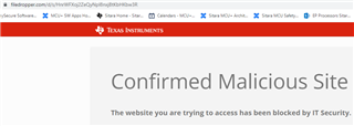

  • I'm baffled.  After many hours of trying to get dmasciSend() to send a string on sciREG1, nothing is happening.  I've gone through the configuration(s) dozen of time and everything seems reasonable.  I've tried various values with no success.  In the sample code, I see comments like the address needs to be set differently for big endian systems, but I see no mention of any of this in the Technical Reference Manual (which is skimpy on a lot of specific detailed items, given the massive amounts of registers and options).  The sample code has comments that seem to conflict with documentation in the manual.  Getting an example code to run on a basic device shouldn't be that difficult.
    I have uploaded my HL_sys_main.c, which should insert into a basic TMS XL2-570LC43 project cleanly.  The addition of Update_DMA_Comp_Flag() to notification.c is optional at this point, since the DMA operation doesn't even seem to be happening at all.  If possible, please run this project and help me debug the problem, possibly with TI hardware support.
    https://filedropper.com/d/s/HnrWFXoj2ZeQyNpI8nxjBtKbHKbw3R
    Thank you very, very, much.

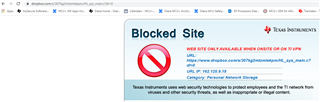

  • Hi Peter,
    I am not able to open the like:
  • Hi Peter,

  • I made the following change, and the code gets somewhat further.  I don't see any output on my Puttty terminal on SCI1 using scidmaSend(), unlike the case with the sciSend() messages.  However, I do now see an BTCA interrupt now, although the offset is 0, so the group A notification is not issued.  I don't know what's causing the output _not_ to display.
    // g_dmaCTRLPKT.PORTASGN = 4; /* port b */
    g_dmaCTRLPKT.PORTASGN = PORTA_READ_PORTB_WRITE; /* port b */
    void dmaBTCAInterrupt(void)
    uint32 offset = dmaREG->BTCAOFFSET;

  • I tested your code with this modification:
    it works:
    I added a breakpoint at line 333:
    /* Enable TX DMA */
    After this line is executed, the DMA transfer starts
  • Thank you so very, very, much for uploading and sharing this project.  Indeed, SCI1 does display the string properly, both at 9600 baud and 230400 baud.  And most importantly, in a reliable and consistent, reproduce-able, fashion.
