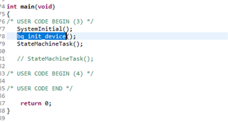

  • Hi ,
    I verified your code and i found the root cause for the issue.
    I saw you are enabling Counter for block-1 in the function "StateMachineTask"
    And this function "StateMachineTask" is calling after the "bq_init_device" function in main loop.
    If you verify carefully the function definition of "bq_init_device", it have while(1) at the end of the definition
    So because of this the processor can't execute the function "StateMachineTask" and it cant start the counter-1 and our compare operations of Counter1 can't be performed.

  • Hi, gundavarapu
    Thank you reply me.
    I mark the while(1) can function,but it still can't enable counter1.
    And I find when the batteries data receive finish the code will exit.
    There should be one infinity loop in your code, if infinity loop was not there then your code program will get terminate. So after commenting while(1) in "bq_init_device" function just try to add infinity loop after "StateMachineTask" function.

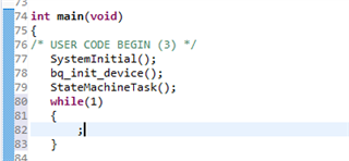

  • Hi, Jagadish gundavarapu
    Thank you reply me.
    Now I set the  infinity loop in my code for LED blinky.
    And I use debug mode to watch the code step by step to trace the code.
    I find the code could be enter StaeMachineTask subroutine but it can't trigger the counter1.
    appendix is my debug video and my modify code zip .Please watch my video Thank you.

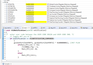

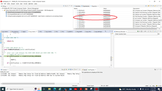

    Now i don't see any mistakes in your initializations, it should work.
    Can you please do the following verifications?
    1. Can you set a breakpoint at starting instruction of "rtiNotification" function, like below
    Don't set breakpoint anywhere else and do continuous run(not step by step) and verify whether it is hitting above breakpoint or not?
    2. If above breakpoint not hitting even after running some 3 to 4 seconds also then just pause the execution and see the RTIFRC1 and RTIU1 register values in register window of debug and the these registers should have a non zero values if the counter1 is running. If counter1 is not running then the values will be zero
    See in my debug i can see non zero values in this registers.
    You can add this window by below navigation
    Jagadish.
    Thank you reply me!
    This is awesome explain for me.I got the value in RTIFRC1 and RTIU1 register.(figure 1)

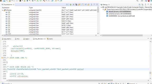

    Now i can work short time, but something strange to the running code.

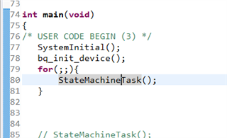

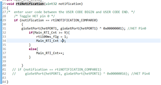

    I write the infinite loop for StateMachineTask(figure 2) , but the code will infinite execute the main( ) .
    I try to find the problem,so I use debug mod to trace.
    When the compare 0 execute one time and the code will go to sys_startup.c to reset the code and it is infinite to do that.
    I show the debug video for you .
    Thank you.
                                          figure 1
                                             figure 2
    This issue is not triggering at my end. Can you please do the following things on your side?
    1. Keep "rtiStartCounter" function out side the infinity loop, remove this function from "StateMachineTask" this function and place this function before starting of infinity loop like below
    This is because, start counter operation is may not required to call again and again. After calling first time itself it will start the counter and the counter will continuously in running.
    2. Keep the breakpoint at start of the main like below and don't place the breakpoints anywhere else
    Now debug the code in continuous run mode and don't do line by line debug. The above breakpoint should hit only one time, that is at the beginning of the debug. If it is hitting again in continuous mode means, then the controller is restarting and there is some error in the code.
    Jagadish.

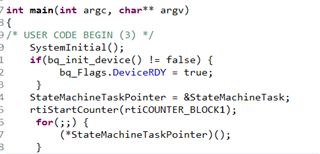

    Thank you reply me !
    I follow your tech and that is didn't change situation,but now I have new find maybe it have relation to the problem.
    when I modify the battery data frame printf in bq_device.c Line:262    for(i=1;i<27;i++), if the data sizes not same with the frame the code will be error(infinity reset the code)
    It can show the data suitable size ,don't show the 0 data like before, now the code just running one time and stuck in the infinity subroutine.
    My 10ms led can work but another LED(100ms) don't, counter1 just count one time and stuck the infinity subroutine.
    "rtiStartCounter(rtiCOUNTER_BLOCK1);" this command write out side the infinity loop, or put the inside is same situation.
    This video is first  show the data correct but it just counter one time and next is show mistake demo it infinity reset.

    Can you try the attached code?
    Here i am calling "rtiStartCounter(rtiCOUNTER_BLOCK1)" function before the "bq_init_device" function.
    And i moved "StateMachineTask" function back to the "while(1)" you commented.
    This ensures your old code as it is, so test it now.
    bq76PL455A-Q1 Example Code 1.0.zip
    Jagadish.
