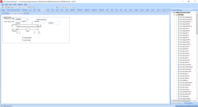

seems like when I try to configure a baud rate for the SCI/LIN modules that is , say 1Meg.....the buad looses resolution...
just want to know how accurate I can get it....guesing using a really off the wall OSC freq in (like 14.73865M). might do it?....
again....just trying to get things to run as quickly as I can to develop some code/hw
per sop...thank you very very much
    The SCI uses the 24-bit integer prescaler P value of BRSR register to select the required baud rates. The additional 4-bit fractional divider M refines the baudrate selection.
    In asynchronous timing mode, the SCI generates a baud clock according to the following formula:
    SCICLK Freq = VCLK / ( P + 1 + M/16 )
    and   Async baud rate =  SCICLK Freq / 16
    When VCLK=75MHz, if you need baudrate=1MHz, then P+1+M/16=75/16= 4.75 -->P+M/16=3.75
    You can choose P=3, M=16*0.75=12
    The HALCoGen doesn't support M fractional divider.
