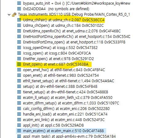

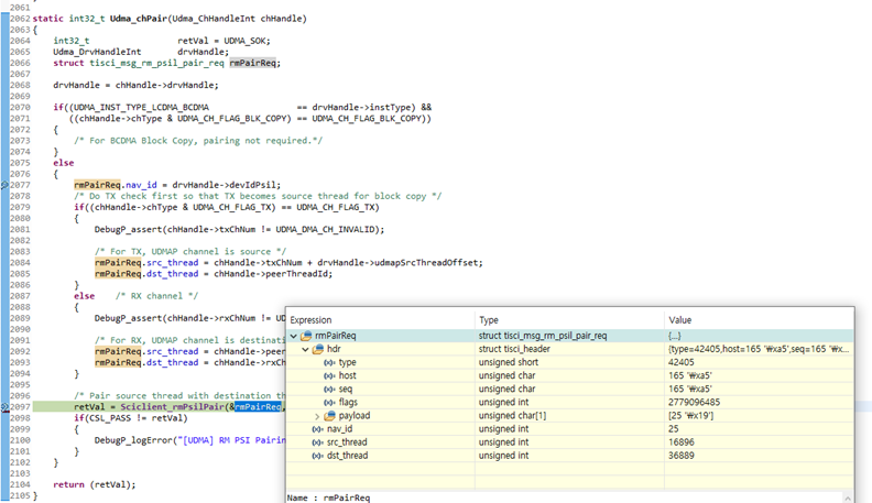

Dear Champs,
My customer failed Enet_open() by returning '-1' and they found 'sciResp.flags & TISCI_MSG_FLAG_ACK Flag ' was not set in the sciclient_service of Udma_chPair() function and return '-1' as below.
Could you please check below call stack and let me know what should be checked further ?
Their MCU+ SDK version is little bit complexted. They are using SBL from SDKv8.3.0, but application was developed on MCU+ SDK v8.2.0.
Do you think this mis-matched version between SBL and application would cause this issue?
Thanks and Best Regards,
SI.
  • They have used same application code with SDKv8.2.0 SDK.
    As they are willing to use CPSW on R0_0 core and PRU-ICSSG enet on R0_1 core, they modify resource file as below and move to SDKv8.3.0 to rebuild it.
    They modified resource file to allocate UDMA resources to PRU-ICSSG enet thanks to below e2e support.
    https://e2e.ti.com/support/microcontrollers/arm-based-microcontrollers-group/arm-based-microcontrollers/f/arm-based-microcontrollers-forum/1115175/am2434-different-result-of-same-function/4159656#4159656
    Even with SDKv8.3.0 SBL, there is no issue to initialize CPSW enet in R0_0 core. So, I'm suspecting there is any missing one in their modified resource file. Please check this.
    Their modified resource file is as below.

  • Hi SI,
    CPSW enet in R0_0 core only in 8.2 release and they could not test it with ICSSG in R0_1 core
    As per above statement below changes  in given rm file are incorrect I think
                .num_resource = 64,
                .type = TISCI_RESASG_UTYPE (TISCI_DEV_DMASS0_PKTDMA_0, TISCI_RESASG_SUBTYPE_PKTDMA_RING_CPSW_TX_CHAN),
                .start_resource = 16,
                .host_id = TISCI_HOST_ID_MAIN_0_R5_2,
                .num_resource = 64,
                .host_id = TISCI_HOST_ID_MAIN_0_R5_3,
    correct  mapping for (CPSW on R5_0) should be
    TISCI_HOST_ID_MAIN_0_R5_0 (35U) Cortex R5FSS0_0 (Secure Context)
    TISCI_HOST_ID_MAIN_0_R5_1 (36U) Cortex R5FSS0_0 (Non-Secure Context)
                .num_resource = 64,
                .host_id = TISCI_HOST_ID_MAIN_0_R5_0,
                .num_resource = 64,
                .host_id = TISCI_HOST_ID_MAIN_0_R5_1,
    Nilabh A.
