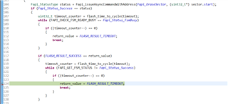

Hi:
I wrote a bootloader library that works with Ethernet, when I start the main application from bank 1 sector 0, the bootloader works fine, but when I start the application from the bank 0 sector 5, where the bootloader ends, it gets stuck at "while (FAPI_GET_FSM_STATUS != Fapi_Status_Success)". But fapi init operation is done successfully.
Bootloader program size: 142Kb
To run fapi in sram I configured the linker as follows.

Bootloader app memory allocation:
Where could I be going wrong? Can you help me?
