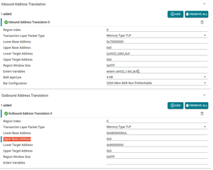

Where can I find information about 'what are Lower Base Address, Upper Base Address, Lower Target Address, Upper Target Address etc?
Part Number: MCU-PLUS-SDK-AM243X
Hi Onur,
The Lower Base Address and Upper Base Address is used for configuring the outbound ATU. The Lower Target Address and Upper Target Address are used for configuring inbound ATU in Pcie_open().
