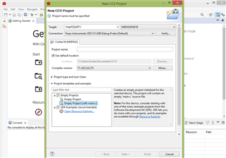

Hi everyone
I am using this board.
I am creating a new project in CCS as:
When I click Verify, I  get this error:
[Start]
Execute the command:
%ccs_base%/common/uscif/dbgjtag -f %boarddatafile% -rv -o -S integrity
[Result]
