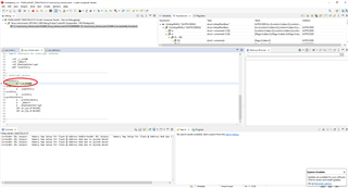

While this example works as expected, I am not able to set a breakpoint in any code before main() (for example, in _c_int00). The breakpoint I am setting show up in the breakpoint window as HW breakpoints (and the action is 'remain halted'), but the code runs all the way to main() before halting. I am trying this with a Debug build with full source visibility.
What am I doing wrong?

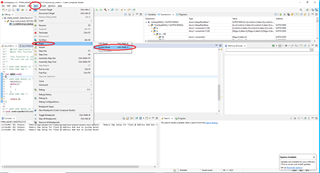

    After launching the debug mode click on "system reset" option shown below
    This will reset the entire controller and move the execution to the reset entry point as shown below
    And now you can do whatever you want, i mean step by step debugging or set break points in _c_int00 function and it will work as you expected.
