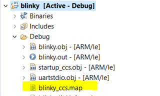

      Do you know how big is your program? You can check the map file in the Debug directory. See below. I see you start the FLASH section at 0x84000. That is more than 0.5MB of space you are not reserving for your code. Why do you want to do that? If your code is more than 0.5MB then it will not fit between 0x84000 and 0x100000. One more comment is that you declare the FLASH memory as (RXW). You should change to (RX). See one of the TivaWare examples for reference.

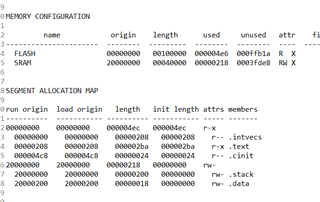

    I did the suggested changes. Following is my map file.
    My updated linker.cmd file is:
    The error now is:
