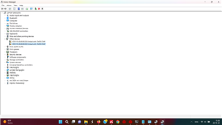

I am working with a LAUNCHXL2-570LC43 launchpad. I am a Linux user and in Ubuntu 2022.04 this device works like a charm. However, many of the software, for example Halcogen, are supplied as a Windows only distribution (significantly degrading developer productivity and software quality). Thus I was forced to switch to Windows for at least part of the project. In Windows 11, the probe is not recognized (I have tried all the obvious things like upgrading the driver: Windows reports nothing is found). A screen shot is attached.

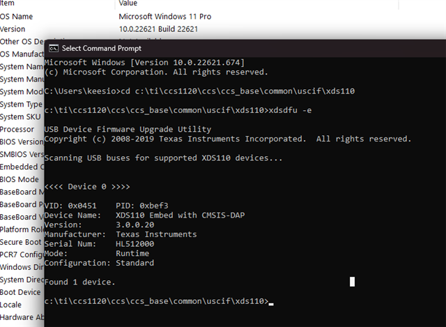

  • There must be some issue with your Windows 11 enviroment. I am able to get the XDS110 on my Hercules LaunchPad detected successfully on my Windows 11 PC. It looks like an issue with the WIndows drivers or the probe was not proeprly enumerated. You mentioned you tried reinstalling the Windows drivers without success. Perhaps it is an enumeration issue. Is the XDS110 connected directly to the PC or is it via some USB hub? If it is the latter, can your try the former? Also, have you tried connecting the launchpad to a different windows PC?

    Have you taken a look at the version number of the probe: Version:       3.0.0.20
    This was *not* the version it came with; I had to upgrade it using the Linux DFU firmware (CCS prompted me to do it; I don't remember the sequence of events that lead to the prompting). After upgrading the CCS running in Linux was happy, but Windows does not even recognize it. I don't think I ever tried it in Windows with the older firmware so I won't know if that upgrade created Windows incompatibility.
    Please verify that your firmware version is the same as mine; if that is the case and it works in Windows 11 for you, I will be puzzled.
  • Have you taken a look at the version number of the probe: Version:       3.0.0.20
    CCS 11.1  debugger requires at least this version of the XDS110 firmware. If the debugger detects a version below this number, it will automatically try to update it. The same happened when I tried connecting to my Hercules LaunchPad with CCS 11.2.0. It detected an older XDS110 firmware and auto updated it to 3.0.0.20 before successfully connecting to the target
