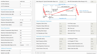

Because of the test needs, it is hoped that the radar can have a better detection accuracy at 80-90 meters and can observe the vehicle parking.
For this reason, I set a file referring to mmWave Sensing Estimator, as shown below
sensorStop
flushCfg
dfeDataOutputMode 1
channelCfg 15 1 0
adcCfg 2 1
adcbufCfg 0 1 1 1
profileCfg 0 77 2 4.20 41.88 0 0 8.21 1 223 6080 0 0 48
chirpCfg 0 0 0 0 0 0 0 1
frameCfg 0 0 120 0 50 1 0
lowPower 0 1
guiMonitor 1 0 0 0
cfarCfg 4 12 2 16 8 4 0 63 63 0 1
doaCfg 3 0 1047 3 600 10 100
trackingCfg 1 0 250 1 0 0 0 90
compRangeBiasAndRxChanPhase -0.0438848 0.12320 -0.62793 0.08932 -0.50342 -0.03458 -0.58853 0.06812 -0.69101 -0.79391 -0.60803 -0.63580 -0.45255 -0.70901 -0.26627 -0.73044 -0.46078
sensorStart
With this configuration file, my radar can track vehicles far away from the radar, with a maximum tracking distance of 113 meters. However, the first position where a vehicle close to the radar can be identified is 90 meters. Theoretically, it should be able to appear from 100 meters. Why?

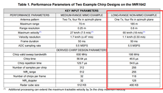

  • Hi,Cesar.My radar is IWR1642.
    In order to meet the requirement of detecting 100m target, I refer to the Design Guide:
    <TIDEP-0090
    Traffic Monitoring Object Detection and Tracking Reference Design Using Single-Chip mmWave RadarSensor>
    Long Range NON-MIMO detection configuration in the document. The transmitting antenna here only enables TX1,like this
    From the document, it can be seen that enabling two antennas does not meet the requirement that I can detect 100 meters.

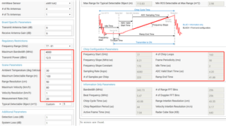

    Therefore, I use mmWave Sensing Estimator to verify whether the parameters are correct. Many files have been modified, but some files have not been generated after being configured on the radar. as follows
    sensorStop
    flushCfg
    dfeDataOutputMode 1
    channelCfg 15 1 0
    adcCfg 2 1
    adcbufCfg 0 1 1 1
    profileCfg 0 77 2 4.20 44.73 0 0 8.45 1 235 5946 0 0 48
    frameCfg 0 0 114 0 50 1 0
    lowPower 0 1
    guiMonitor 1 0 0 0
    sensorStart
    Then I don't know what went wrong. So I want to ask whether there are detailed descriptions of the parameters related to cfg file configuration? Will modifying cfarcfg and doacfg improve the detection effect? How to modify? thank you

    Unfortunately the IWR1642 will not be able to detect a 100m target with 1Tx. There is not sufficient power.
    In our experiments, we are able to detect a car ~ 80m with 2Tx . Please see the SRR demo provided in the Automotive Toolbox Lab.
    Please understand this before we discuss other questions.
