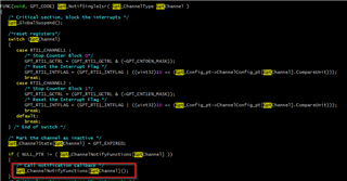

  • Hi Ravi,
    The MCAL application example you are using is from TI BMS team. From your screenshot, both GPT channel 0 and channel 1 are enabled,.
    Did you start channel 1 by calling Gpt_StartTimer(...)? For example Gpt_StartTimer(1, 2000) --> channel 1 and 2ms for tick=1MHz
    i am not seeing the callback 'BQ761xNw1GptCbk()'
    The BQ761xNw1GptCbk() callback function is defined in gptCallout.c

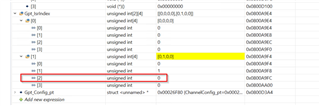

  • Hi Q J,
    Yes, i am calling 'Gpt_EnableNotification' and then calling Gpt_StartTimer( channel, time) for both the channels. The MCAL version i am using is 5.40, i also tried in version 6.0.0. Yes we are working on the TI BMS CDD software.
    I tried below, and I am seeing the issue in both the cases.
    1) Assigning separate counter channels and compare units for the 2 GPT timers.
    2) Assigning single counter channel for both the GPT timers and separate compare units for the GPT timers.
    I also try enabling the interrupts for all the compare units.
    Do you see any issue in the GPT configuration file I shared with you.
    Ravi
  • Hi Ravi,
    BQ761xNw1GptChannel in your configuration uses the RTI compare 2, so the ISR handler should be defined in VIM vector table:
    The MCAL driver uses &Gpt_Ch2Isr for RTI compare 2:
    Change:
    to:

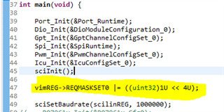

  • Thank you QJ for the quick response. Attached is the files you asked.for.
    I see the GptChannelId '0' and GptCompareUnit '0' is used by OS 'vPortPreemptiveTick' so we cannot use it for our application, Is it possible to use 'BQ761xNw0GptChannel' ( GptChannelId 1, Compare unit 1 ) and 'BQ761xNw1GptChannel' (  GptChannelId 1, Compare unit 2 ) at the same time, if so what is the channel number to pass as argument to Gpt_StartTimer() for each of this.

  • Hi Ravi,
    Please add one instruction to your main() code to enable RTI compare2 interrupt:
        vimREG->REQMASKSET0 |= ((uint32)1U << 4U);
  • Hi Q J,
    We need to use EB tresos 24 to open the configuration file.
    I made the below changes, I am receiving the interrupt Gpt_Ch2Isr, but 'BQ761xNw1GptCbk()' is still getting triggered from  from 'Gpt_Ch1Isr' . I see ' 'Gpt_ChannelNotifyFunctions' array size is '2' (maximum channel number).

  • My understanding is that the Gpt_IsrNotifyFunctions is determined by the channel umber, for example BQ761xNw1GptChannel.
    If the interrupt is generated by RTI1_COMPARE2, the BQ761xNw1GptChannel is returned value of Gpt_GetConfiguredChannelForCompareUnit(RTI1_COMPARE2);
    Gpt_IsrNotifyFunctions is pointing to  &Gpt_WakeupContIsr,
  • a) In the 'Gpt_Ch2Isr()' function we can see the index to 'Gpt_IsrNotifyFunctions' array is 'Gpt_IsrIndex[Channel][RTI1_COMPARE2]'
    #if ((GPT_CFG_ISR_TYPE == GPT_ISR_CAT1) || (GPT_CFG_ISR_TYPE == GPT_ISR_VOID))
    #pragma CODE_STATE(Gpt_Ch2Isr, 32)
    /*SAFETYMCUSW 69 S MR:3.4 <INSPECTED> "Reason - To indicate interrupt subroutine" */
    #pragma INTERRUPT(Gpt_Ch2Isr, IRQ)
    void Gpt_Ch2Isr ( void )
    #elif (GPT_CFG_ISR_TYPE == GPT_ISR_CAT2)
    ISR( Gpt_Ch2Isr )
    #endif
    uint8 Channel;
    Channel = Gpt_GetConfiguredChannelForCompareUnit(RTI1_COMPARE2);
    Gpt_IsrNotifyFunctions[Gpt_IsrIndex[Channel][RTI1_COMPARE2]] (Channel);
    b) In Gpt_StartTimer(), we can see 'Gpt_IsrIndex' values are assigned from channel mode.
    /*Set the channel mode for notification index*/
    Gpt_IsrIndex[Gpt_Channel][Gpt_Config_pt->ChannelConfig_pt[Gpt_Channel].CompareUnit] = ChannelMode_t;
    If we see the value of Gpt_IsrIndex[1][2] is '0'.
  • It should be 1, right?
    GPT_CH_MODE_ONESHOT = 1;
  • Yes right it should be 1, I am not sure why its '0'
