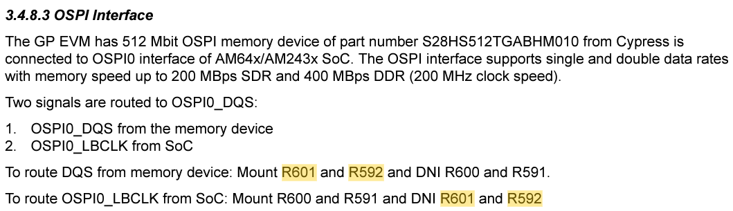

Our customer found an error in the TMDS243GPEVM documents about the implementation for DQS and LBCLK in OSPI.
R601 and R592 to route from memory device to DQS not found on TMDS243GPEVM. It seems correct to swap R152 and R600 and mount R591.
The TMDS243GPEVM used by our customer seems to be the new revision "PROC101B (002)".
Has it been modified for the new revision "PROC101B (002)"?
Could you provide schematic for the new revision "PROC101B (002)"?
