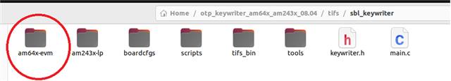

    am64x-evm is a ALV package and even if your device is am243x-evm the am64x-evm package should work.
    My suggestion for you would be to try the same with this package.
