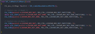

  • Hi ,
    In SBL QSPI, Bootloader_socInitL2MailBoxMemory() is called which calls, SOC_rcmMemInitL2Memory() and that initializes Bank 2 and Bank 3.
    Writing to this registers, initializes the memory with 0.
    Please try commenting the code, which you do not intend to initialize (here L2 Bank 3), re-initialize the library and try with the custom SBL.
    Hope this helps.
    Aakash

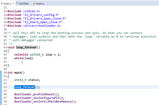

    As you said, the "Bootloader_socInitL2MailBoxMemory" function initializes the memory.
    But the current problem comes before that.
    Currently, right after the main function starts, I use the "loop_forever" function to hold the program counter and check the memory.
    But the above problem still occurs.
    However, this RAM initialization problem occurs only when Warm Reset is performed in Application SW.
    RAM initialization does not occur when performing a WarmReset within QSPI_SBL.
    I wonder if there is any branch before QSPI_SBL is loaded.

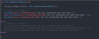

  • Hi ,
    I tried with Hello World Example and modifying the value at 0x701FFFE0 location in case of QSPI boot with the following changes in the driver.
    It works for me. Please check something is not correct on your end OR check the linker file of your application. Hope you are not initialing the entire SRAM memory as this is part of your *.bss region.
    Aakash
    Thank you for quick response.
    However, the result is not the same as my phenomenon.
    I performed a test using only the example below and reproduced the problem.
    Example Project
    1. sbl_qspi_am263x-cc_r5fss0-0_nortos_ti-arm-clang
    I added only the loop_forever function as shown below.
    2. hello_world_am263x-cc_r5fss0-0_nortos_ti-arm-clang
    I added code to only write 0x1234 to the 0x701FFFE0 area and call the SOC_generateSwWarmReset function.
    Test and Result
    1. Invalid values stored in SRAM after POR
    2. The result of changing the "loop" variable value to 0 to escape the loop_forever function and pausing after running.
    The loop_forever function is before the Bootloader_socInitL2MailBoxMemory function is executed.
    So my expectation is that 0x1234 is stored in the 0x701FFFE0 area due to the action in the "hello_world_am263x-cc_r5fss0-0_nortos_ti-arm-clang" project.
    But the RAM has been initialized.
    if the "hello_world_am263x-cc_r5fss0-0_nortos_ti-arm-clang" project hadn't been done, WarmReset would not have happened, so this is a false assumption.
    Also, project "hello_world_am263x-cc_r5fss0-0_nortos_ti-arm-clang" has no other branches.
    The linker in both example projects above does not define the 0x701FFFE0 region.
    Can you let me know if there are any problems with my tests?
