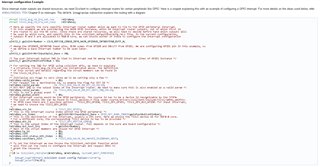

    My customer has some questions regarding to GPIO interrupt setting.
1. In sdk 8.5 syscfg, the interrupt mux route is limited to route 8/9 in example gpio_input_interrupt_am243x-lp_r5fss0-0_nortos_ti-arm-clang. I tried to bypass syscfg to ask other route like 0,5,6.. by sciclient api but it return fail. I can't allocate requested resource.

static void Sciclient_gpioIrqSet(void)
    int32_t                             retVal;
    struct tisci_msg_rm_irq_set_req     rmIrqReq;
    struct tisci_msg_rm_irq_set_resp    rmIrqResp;
    /* For setting the IRQ for GPIO using sciclient APIs, we need to populate
     * a structure, tisci_msg_rm_irq_set_req instantiated above. The definition
     * of this struct and details regarding the struct members can be found in
     * the tisci_rm_irq.h.
    /* Initialize all flags to zero since we'll be setting only a few */
    rmIrqReq.valid_params           = 0U;
    /* Our request has a destination id, so enable the flag for DST ID */
    rmIrqReq.valid_params          |= TISCI_MSG_VALUE_RM_DST_ID_VALID;
    /* DST HOST IRQ is the output index of the interrupt router. We need to make sure this is also enabled as a valid param */
    rmIrqReq.valid_params          |= TISCI_MSG_VALUE_RM_DST_HOST_IRQ_VALID;
    /* This is not a global event */
    rmIrqReq.global_event           = 0U;
    /* Our interrupt source would be the GPIO peripheral. The source id has to be a device id recognizable by the SYSFW.
     * The list of device IDs can be found in tisci_devices.h file under source/drivers/sciclient/include/tisci/am64x_am243x/.
     * In GPIO case there are 3 possible options - TISCI_DEV_GPIO0, TISCI_DEV_GPIO1, TISCI_DEV_MCU_GPIO0. For input interrupt,
     * we need to choose the TISCI_DEV_GPIO1
    rmIrqReq.src_id                 = TISCI_DEV_GPIO1;
    /* This is the interrupt source index within the GPIO peripheral */
    rmIrqReq.src_index              = TISCI_BANK_SRC_IDX_BASE_GPIO1 + GPIO_GET_BANK_INDEX(GPIO_PUSH_BUTTON_PIN);
    /* This is the destination of the interrupt, usually a CPU core. Here we choose the TISCI device ID for R5F0-0 core.
     * For a different core, the corresponding TISCI device id has to be provided */
    rmIrqReq.dst_id                 = TISCI_DEV_R5FSS0_CORE0;
    /* This is the output index of the interrupt router. This depends on the core and board configuration */
    rmIrqReq.dst_host_irq           = Board_getGpioButtonIntrNum();
    /* Rest of the struct members are unused for GPIO interrupt */
    rmIrqReq.ia_id                  = 0U;
    rmIrqReq.vint                   = 0U;
    rmIrqReq.vint_status_bit_index  = 0U;
    rmIrqReq.secondary_host         = TISCI_MSG_VALUE_RM_UNUSED_SECONDARY_HOST;
    /* To set the interrupt we now invoke the Sciclient_rmIrqSet function which
     * will find out the route to configure the interrupt and request DMSC to
     * grant the resource
    retVal = Sciclient_rmIrqSet(&rmIrqReq, &rmIrqResp, SystemP_WAIT_FOREVER);
    if(0 != retVal)
        DebugP_log("[Error] Sciclient event config failed!!!\r\n");
        DebugP_assert(FALSE);
    return;

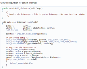

Question:
1. Do we have anyway to ask other route ?
2. Do we have any document to tell customer the DMSC pre-defined resource?
3. Can customer ask individual GPIO interrupt instead of bank interrupt?
4. If customer want to use the same route for all cores, for example route 8 to interrupt all cores at the same time, how can they do?
