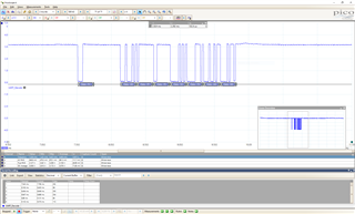

  • Hi Amruta,
    thank you very much for your response. In fact, it is not Uart2 but I labeled the UART "UART2Rotor". It is using UART0. You can see the received message here:
    The signal is measured at the RX pin and it is independent of the UART mode ("RX only" OR "TX and RX").
    The RXDATA register stays empty:
    When UART mode is set to "TX and RX", the registers look like this and data is received as expected:
    Would additional register entries be helpful for you?

  • Hi Samuel,
    Where are you receiving data from? If you monitor the source of the RXDATA, is it being transmitted correctly?
    Amruta
  • Hi Amruta,
    I am receiving data from another MCU. The bits are transferred correctly - as the serial decoding shows. I have measured the waveforms above directly at the RX pin. I am quite sure that the data stream is not corrupted. Even if it was, I should see some kind of UART error when receiving, shouldn't I?
    Can you check whether you are facing the same problem when you set the UART to "RX only"?
    I am now using Sysconfig 1.15 and SDK 0.56.
    Best regards
    Samuel
  • Hi Samuel,
    I see the issue you are talking about. Let me do some troubleshooting and get back to you by tomorrow.
    Amruta
  • Hi Samuel,
    For now, you will have to use a workaround; it seems like the TXE bit has to be enabled for RX only to work, but you should still be able to use the TX pin for other purposes.
    Above your main function, try initializing:
    static const DL_UART_Main_Config gUART_1Config = {
        .mode        = DL_UART_MAIN_MODE_NORMAL,
        .direction   = DL_UART_MAIN_DIRECTION_TX_RX,
        .flowControl = DL_UART_MAIN_FLOW_CONTROL_NONE,
        .parity      = DL_UART_MAIN_PARITY_NONE,
        .wordLength  = DL_UART_MAIN_WORD_LENGTH_8_BITS,
        .stopBits    = DL_UART_MAIN_STOP_BITS_ONE
    and in your main function, calling (change UART_0_INST to whatever your UART instance is defined as):
        DL_UART_Main_init(UART_0_INST, (DL_UART_Main_Config *) &gUART_1Config);
    Keep the rest of the configurations the same (RX only in SysConfig, etc.).
    I will escalate this issue and keep you updated on the resolution timeline, but for now this workaround should work. Let me know if you have any questions implementing it or otherwise.
