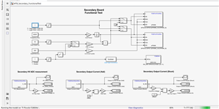

We are using this devices to monitoring a board designed to control another two high power boards via Simulink and serial communication. The issue is that the new debugger are not able to connect to the board that is using a F280048 microcontroller, while the previous debugger it is capable to connect.
As you can see in this picture, with the first debuuger is running without issues and I able to control it.
But with any of the new debuggers I am getting this error. And I am not changing anything (cables, program to load, setting on the serial ports, board to use) just changing the debugger.

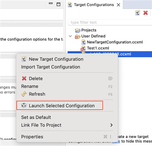

    One more test we should try. Launch the target configuration. In the Target Configuration, select the one you created, right-click, and press 'Launch the  Selected Configuration"
    Once it is launched, select C28x in debug window, and then right-click, and select "Connect"
    Let me know if you are able to connect.

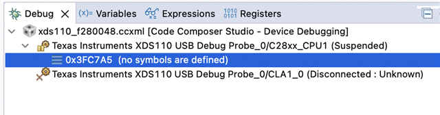

  • Hello.
    I think that that the expected result from you test.
    Right?
    Yes, That is correct. Your board is fine and XDS110 emulator is fine.  For debugging Simulink, you will need to post to MathWorks forum.

  • But my concerns with this test, is that were made with jtag, right?
    But thats not the issue, because with Simulink Im still able to download the program to the microcontroller and see the changes via osciloscope connected to a EPWM output.
    The problem start the Im trying to use UART interface to control it.
