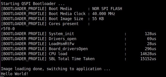

[Cortex_R5_0] [QSPI Flash Diagnostic Test] Starting ...
[QSPI Flash Diagnostic Test] Flash Manufacturer ID : 0x20
[QSPI Flash Diagnostic Test] Flash Device ID       : 0xBA20
[QSPI Flash Diagnostic Test] Executing Flash Erase on first block...
[QSPI Flash Diagnostic Test] Done !!!
[QSPI Flash Diagnostic Test] Performing Write-Read Test...
[QSPI Flash Diagnostic Test] Write-Read Test Passed!

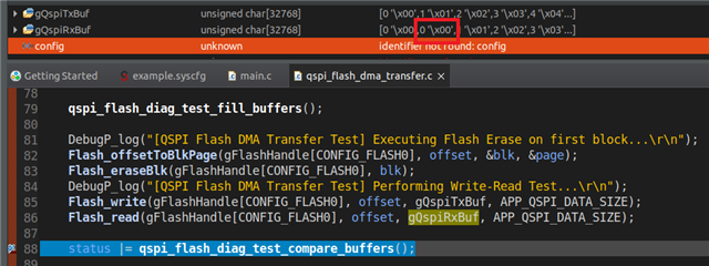

2. We have checked the following settings
- Check for 1s-1s-1s mode (We use 1s mode), WEL have to set 1.  - done
- HW reliability  : Make sure Micron flash can pass boot qspi_flash_dms_transfer (32KB) & qspi_flash_transfer (256B) test - pass
- To increase your timeout value since SPI mode is much slower - done

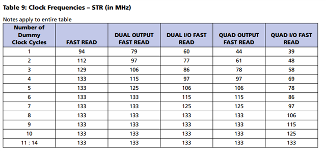

    1.I see that TI document mentions "Good signal integrity of this memory interface is critical for basic QSPI boot operations of the AM263x MCU" May I ask if we replace the Infineon flash on the LP-AM263x with the MT25QL512ABB flash as below picture , will it be the possible reason for "flash can not boot issue"?
    2.Here is the answer to your question

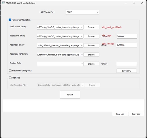

    - You already mentioned you tried to program the image via flash writer. Did you use the sbl_uart_uniflash or the sbl_jtag_uniflash for the same ?
    -> We use uart_uniflash_gui.py to program the image as below picture
    - If yes, did you update the required flash related changes in the sysconfig for the above mentioned SBLs ?
    -> Yes. please find the sysconfilg files as below
    a.sbl_uart_uniflash
    example_syscfg_sbl_uniflash.zip
    2.sbl_qspi
    example_syscfg_sbl_qspi.zip
    3.App image
    example_syscfg_app_image.zip

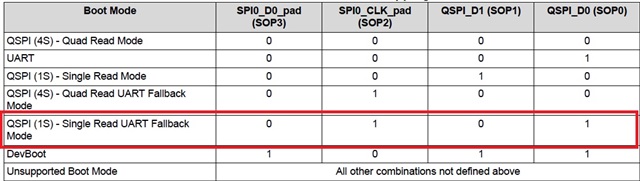

    Just to confirm that the boot mode on the LP you have set is QSPI (1s) which is 0101. Launchpad should be in 1010 i.e. something like this.
    Can you please try the same and confirm ? This is because, QSPI might work or might not work depending on the hardware settings but the SPI hardware is absolutely verified by you, I suggest you to start with SPI boot.
    Aakash

  • Dear Aakash :
    -> We have repeatedly confirmed that the BOOTMODE Pin(1s-1s-1s) is correct, just like your captured picture.
    Wilson

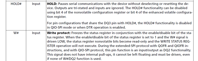

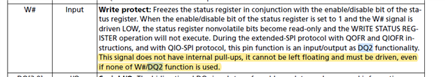

  • Wilson, Aakash,

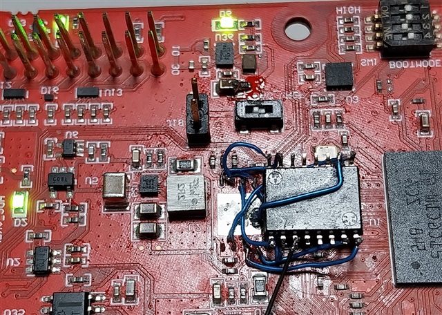

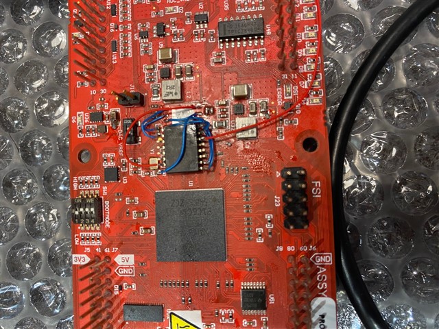

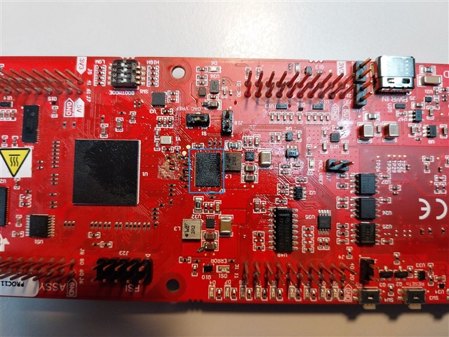

         Based support today, we tested two boards with the same code.  one board even can't pass qspi_flash_diag in 1s-1s-1s mode.
    The other board can use python scripts to load sbl_uart_uniflash and program sbl_null successfully. However, it still fail to boot up.

  • Wilson,
          Did you add 8 dummy cycles when you use 0x0B fast read  command? It needs to modify low level driver lib before you compile flash diagram and Xfer test utilities. If you just modify syscfg in these application, it won’t work. Please check driver source code.
    Andre
  • Hi Wilson Sun,
    The Datasheet mentions that the 0x3 is the valid read command for 1s-1s-1s and for fast read (0x0B) you should also set the dummy cycles as 8 or higher.
    For 1s-1s-4s i.e. 0x6B you must make sure that the dummy cycles is 10 or higher. Also make sure the QE bit is set.
    Aakash

    1. My suggestion would be to start with 0x0B (1s-1s-1s)
    -> We use "dma transfer" to verify it ! it always fails and show below message.
    [Cortex_R5_0] [QSPI Flash DMA Transfer Test] Starting ...
    [QSPI Flash DMA Transfer Test] Executing Flash Erase on first block...
    [QSPI Flash DMA Transfer Test] Performing Write-Read Test...
    ERROR: qspi_flash_diag_test_compare_buffers:124: QSPI read data mismatch !!!
    Some tests have failed!!

  • Dear Aakash:
    When using the 0x0B read command, it is found that when running the dma transfer program, one more ('0') will be read, as shown in the figure below, every 31 bytes behind the Array, there will be one more '0'
    Wilson

  • Dear Aakash:
    Can you share the exact read and write values in the buffer
    -> I dump the memory as attached file.
    memory_dump.zip
    example_for_MT25QL128ABA_1s1s4s.zip
    Thanks!
    Wilson

    2.How to prove sbl_qspi and prove that it is no problem?
    I have a suggestion (just a hack) which will give you good confidence.
    1. For now you can program SBL, Application etc. via UNIFLASH which is working for you.
    2. Now put the device in UART Boot Mode, and send the sbl_qspi.tiimage via XMODEM (using Tera Term or xmodem utility of linux)
    This will boot your SBL_QSPI via RAM and the SBL_QSPI will boot the application via Flash. You can try this flow for now. Apologies for the inconvenience but we are working on the fix.
    Aakash

  • Hi Wilson Sun,
    Let me know if you try the method -

    1.Let me know if you try the method ,This will boot your SBL_QSPI via RAM and the SBL_QSPI will boot the application via Flash.
    -> Thanks for your suggestion  Please find the verification result as below

  • Hi ,

  • Can you SET bootstrap configuration to b’0010 and try ?
    Also connect to R5 code and share following memory dump
    4KB from 0x80000
    4KB from 0x70000000
    4KB from 0x60000000
    I am considering IO2/IO3 PUs are present.
    Thanks & Regards,
    Ajay

  • Andre ,
    Please find my  comments for the respective queries.
    1. Yes , It is 1S-1S-1S mode , want to check , Data has any corruption due to which boot is failing , Ideally this mode should work.
    Device also suipports , FAST read for with ReadCommad 0x0B and Dummy Cycles 8
    2, Memory dump in Functional Single Read mode only
    Thanks & Regards,
    Ajay

  • Hi all,
       Issue closed by add 10K ohm external pull-up resistors on DQ2/WP# and DQ3/Hold# pin.
    According to Micro Flash datasheet, these two pins do not have internal pull-up, external pull-up are mandatory.
    We strongly suggest qspi_dma_transfer test demo project use identical setting with RBL no matter 1s-1s-1s mode or 1s-1s-4s mode.
    In this case, QSPI is set to mode3@40Mhz. DQ2,DQ3 should be set to no pull.  Flash use 0x0B command with 8 dummy read clock cycles.
    We can find issue more efficiently.
    Andre
