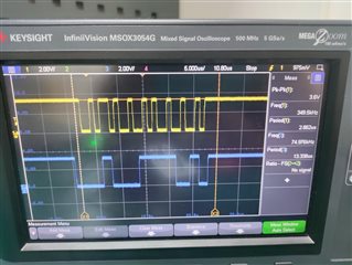

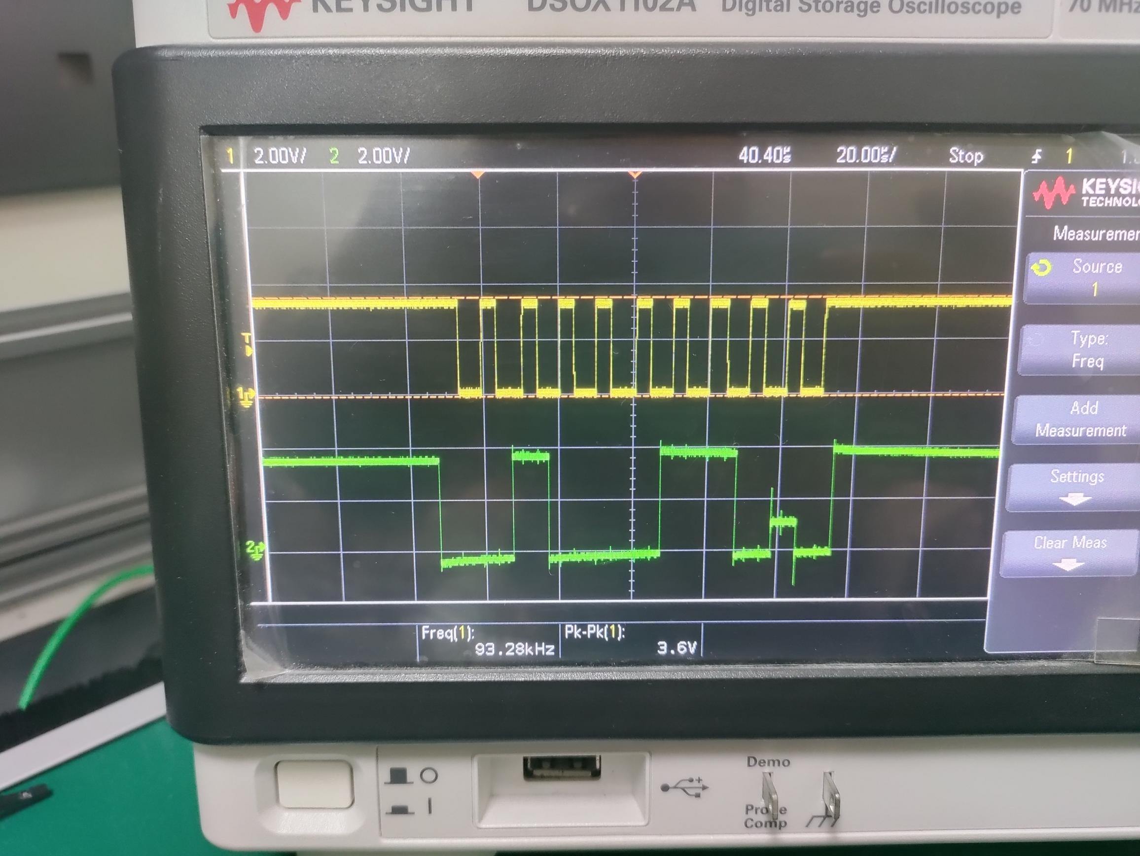

 But from the scope capture, only single I2C send command seems to be working not multiple.
 Please guide for the same.
Kiranjit
      Please look at your scope where I circle the ACK/NACK bit. SCL shows 0x27 is put out as the slave address followed by R/W bit equal to 0 which is a command to write to the slave. However,lLooks like the slave is not returning an ACK to the master and hence the SCL is pulled high during the ACK/NACK phase. You need to investigate why the slave is not driving the ACK when it receives the command from the master. When the master is not getting an ACK from the slave, it is not able to proceed further. You can check the DATACK and ERROR bit in the I2CMCS register and I believe they are set high.

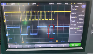

  • Hi Charles,

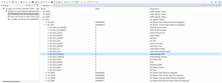

    I checked the status register, I2C0MCS in debug mode of CCS. The DATACK and ERROR bits are set to LOW.

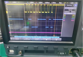

    The scope capture shows the following image sometimes:
    Kiran
  • Hi Kiran,
      The ACK bit is half high. What is the pullup you resistor you have? It seems like the slave device is barely able to overcome the pullup when it tries to drive it low. Do you have any scope cap that shows the ACK is low?
      Can you call I2CSend(DI_SLAVEADDRESS, 0, 0, 0, 0x01) so only one word is written to the slave? I want to see how a simple one word write is shown on the scope.

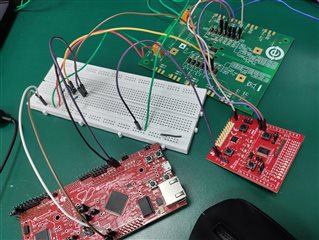

      - Can you try on the LaunchPad? Please show waveforms when connecting LaunchPad to your IO expander.
      - Do you have another custom board(s) to try? Can you replicate on different boards?
      - Can you try to make your example as simple as possible. Perhaps, first reference the simple example at C:\ti\TivaWare_C_Series-2.2.0.295\examples\boards\ek-tm4c1294xl-boostxl-senshub\humidity_sht21_simple.
    To run the sample code in in my I'd need to understand this example first, I don't know where should I give the address of IO expander IC?

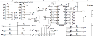

    Also, I'm testing using Launchpad and EV-Boards of ADUM3151 isolator and IO-Expander EVM (setup shown below). I'm giving I2C SCL, SDA signals from Launchpad to IO Expander EVM via isolator.
    For the IO-Expander I'm using slave address as 0x27(screenshot of schematic given below), since all three address lines (Pins 2,3,21) in the EV-Board are pulled up (we've replaced the IC TCA6416 and soldered TCA9555PWR in the evaluation board)..
    If you've any suggestions, please let me know.
    Kiran

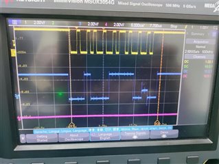

      I look at one of your earlier scope cap and you show. See below. In this cap, the slave is not replying ACK. As you can see, without the ACK, the master terminates. I'm not familiar with TCA9555 device. You need to consult with TCA9555 forum support so they can assist and help you debug better. Somehow, TCA9555 does not recognize 0x27 as the address.

  • Thread in the interface forum: Unable to send multiple I2C data to TCA9555PWR But as far as I can see, the problem is not caused to the TCA9555.
    The captured SDA waveforms show overshoots on the rising edge, which indicates that the SDA pin is not configured as open-drain, but as push/pull. This means that the call to GPIOPinTypeI2C(GPIO_PORTB_BASE, GPIO_PIN_3) did not work, or was overridden later.
    (I do not know anything about the TM4C; how would one read back and check the GPIO configuration?)
      There is nothing in the code that you need to take care for synchronization between SDA and SCL. It is supposed to be handled by the hardware. Can you run I2C at 100kHz? I want to see how the bit timing behaves compared to 400kHz.

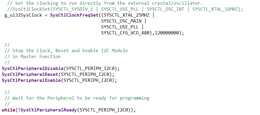

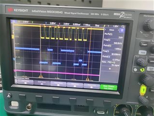

  • Hi Charles,
    I did the following changes in the code.

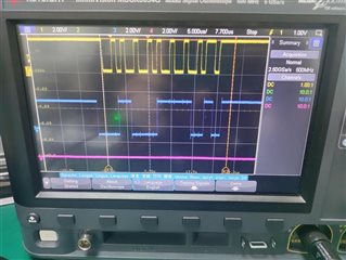

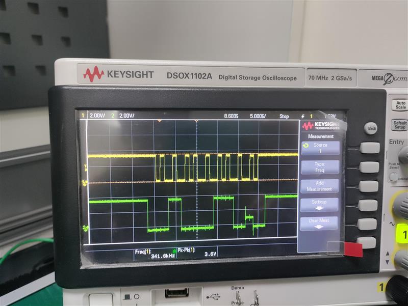

    Please see scope capture for 100kHz and 400kHz in case of 2k and 4k7 pull up.
    100kHz (2K pull up)
    400kHz (2k pull up)
    100kHz (4k7 pull up)
    400 kHz (4k7 pull up)
    Please give your suggestions.
    Kiranjit
      I don't know how to make out this myself. Normally I will expect a lower pullup resistance to be used for higher I2C baudrate. However, on your scope, it seems 4k7 for 400KHz has better waveform than 2k. Regardless of what resistor to use, you seem to still have problem on NACK on both 100kHz and 400kHz. Do you have another LaunchPad to try? Can you repeat the same thing?
