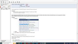

Are there any guides or examples for injecting any of the group 3 ESM errors for this MCU?
In particular interest would be any one of the L2RAMW errors:
  • 3.3 L2RAMW - double bit ECC uncorrectable error
  • 3.14 L2RAMW - Uncorrectable error Type A (This one is not possible I believe)
  • 3.15 L2RAMW - Address/Control parity error
I have studied the examples from the safeTI library, but for this particular MCU there is only an example for ECC "2-bit error forcing", not "2-bit inject". Those tests, using the TRM 8.2.6 Diagnostic Test Procedure only seem to produce group 2 error "L2RAMW - Uncorrectable error type B".
