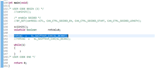

  • Thanks for your reply.
    I am not running in debug mode and I use RDA for the test. I corrupt the data with CAN_FLIP_DATA_1BIT which represents (uint32)0x1u. Unfortunately I'm still frequently seeing the DEFLG bit being set in the ECC Diagnostic Status Register instead of the SEFLG bit.
    Cameron

  • Jagadish,
    Unfortunately I can't attach my code but I am using the SL_SelfTest_CAN() function for the TMS570LC4357 without any changes from sl_selftest.c in the SafeTI Diagnostic Library version 2.4.0 (downloaded here https://www.ti.com/lit/sw/spnc043b/spnc043b.zip?ts=1669743014857&ref_url=https%253A%252F%252Fwww.ti.com%252Ftool%252FSAFETI_DIAG_LIB%253FkeyMatch%253DSAFETY%2BDIAGNOSTICS%2BLIBRARY ).
    For now I am only using  the CAN_ECC_TEST_MODE_1BIT test for DCAN1.
    Cameron

  • I was able to slightly modify your SL_SelfTest_CAN() function as follows and test it in my code. Instead of clearing the errors in ECC_CS and ECCDIAG_STAT, I checked their values later, so I was able to verify that I am still seeing DEFLG (bit 8) being set instead of SEFLG (bit 0) more than half the time in both ECC_CS and ECCDIAG_STAT.
    I tested it with Level 0 Register Optimization as well as No Optimization configurations with the same result.
    Also I noticed that your code defined msgNo as 1u while I had it defined as 2u. I tried your function both ways and still saw DEFLG being flagged more frequently than SEFLG.
    Any suggestions?
    Cameron

  • Actually, I'm using SCI to send serial output with the ECC_CS and ECCDIAG_STAT contents after running the above code. They continue to show that DEFLG is frequently being set instead of SEFLG.

  • Correct, I am flipping the single bit using CAN_FLIP_DATA_1BIT (which equals 1), and I am not calling the test function within the while loop.

  • Thanks for the update, Max. May I ask how you implement the auto init of the CAN RAM?
  • Sure. Be aware that an auto init should be done after activating ECC and before doing the test.
    This does not fix the 2bit error when injecting 1bit error. At least for us.
    Using the auto init again, after testing is done is just a way to clean up the CAN RAM.
    That said you have to do the following:
    1. Enable "Global memory hardware initialization" in MINITGCR Register (TRM Chapter 2.5.1.21)
    2. Set the bits in MSINENA Register, that activate the auto init in CAN-Ram (TRM Chapter 2.5.1.22)
    3 Wait for MINIDONE bit in MSTCGSTAT Register to be set (TRM Chapter 2.5.1.23)
    4. turn of auto init
    The Sequence is described in TRM 2.2.4.2 you need table 2-7 to determine which bits to set
  • Hi Max and Jagadish,
    I added auto-init of CAN RAM just after activating ECC and before running the test, and this appears to solve the issue on my end.
    Thanks very much for your help,
    Cameron
