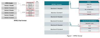

Is there details info about RPRC file format like below picture? Below is another thread about similar questions while I could not open the link suggested in the thread, and I'm not sure if AM263X RPRC is the same as other device.
Could you help check with tools team to get details? Thanks a lot!

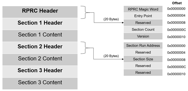

Hi Jane,
Is there something in particular you are looking for that you are not able to find in the picture ?
AM263x RPRC details are present in the link.

I just find the RPPC introduction application notes based on AWR1642 device, if this format is the same as AM2634, we could close this ticket, thanks!
Jane
Hi Jane,
Except for Core-ID the information in this document is same as AM2634. Also the CRC is not appended in case of AM263x.
Aakash
Aakash,
Do you mean the Device ID field is followed by image size info directly or the CRC field in this document is replaced with reserved field? Thanks!
Jane

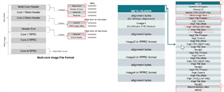

Hi Jane,
Pointing out the changes as per my analysis.
not this -
Hope this clears out a lot of things.
