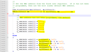

Hello forum!
A MSP432E401Y should get new firmware from a revolutioin  pi using the bsl-scripter.There's an internal network with the pi, the msp432 and some other devices, communicating via modbus. But  flashing new firmware doesn't work.
So I build this on my desk: A PC, a rapberry pi and the PCB with the MSP432 are connected via a switch. When the pi only sends the firmware to the MSP, it works.
So additional traffic has to be added. A Browser of the PC shows the http-Site from the MCU, which is updated every ten seconds.Addtional traffic was added this way. And the flashing does not work any more. The output of the Scipter was shown on the terminal:
      [ACK_ERROR_MESSAGE]Unknown Error!
      Time elapsed of writing 0 bytes : 20.43 seconds
      Speed of writing data :0(kB/s)
The receiving of a tftp-package wasn't acknowledget. But why does the flashing over the ethernet only works, if there's no additional traffic on the line?
On the mcu there's the bootloader serial_emac_flash.
Thanks in advance,
Guenther

  • I've recorded a WireShark protocoll and are looking now how to upload the file.
  • I'm sorry. I can't upload the file either via Insert nor via drag and drop. I tested it with Windows 10 and with Ubuntu. I'll look for alternatives.
    BR Guenther
  • The IP-addresses of the network:
    PC:           192.168.1.5
    Rpi:          192.168.1.20
    MSP432: 192.168.1.10
    Here is the part of the Wireshark file (exported to a Textfie):
    in italic and bold: PC asks for the address that was used by the msp
    in Bold: detction of the duplicate use of the ip-address

    A virgin MSP432E device will not have a preprogrammed MAC address unlike the LaunchPad. You will need to program the MAC address yourself. Once you program the MAC address, they are stored in USER0/USER1 registers.
  • MAC=50:17:e9:10:00:fd
    This is our default Emergency MAC address. The USER0/USER1 registers aren't used yet.
      Please refer to bl_emac.c file for details. It looks like your USER0/USER1 are not programmed with the MAC address and hence it defaults to 00:1a:b6:00:64:00 as shown in your log.
