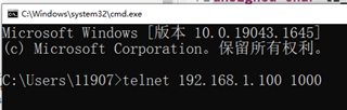

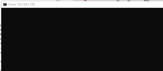

  • Hi Jim,
    It seems that the PC can link to device successfully but the device cannot enable Telnet service. I enter ”telnet 192.168.1.100 1000“ in Wndows Terminal like picture_1.
    After hitting Enter key, it becoms shown in picture_2.
    Throughout the process, I used WireShark tools to capture packets and the result is shown as picture_3. Please help to check it.
    My PC IP is 192.168.1.20 and the device IP is 192.168.1.100. The Telnet port number is 1000.

  • I only ever tried connecting with putty, so I'm not sure.
    When you say that the Telnet port is 1000, I assume that means you changed the default from 23 using the Telnet setting in the syscfg GUI!
    Should be OK but I only ever used the default.
    Have you seen the service report function state that Telnet has started on the Launchpad?

  • Ah, I can see why you might expect that to work, however:
    Many of the sample projects use netIPAddrHook() to start a network task, with a hard coded port number, when an IP address has first been assigned.
    Telnet is a service, so is started differently. When you check Telnet in the syscfg GUI, the following code is added to the generated code file ti_ndk_config.c. Here, the port number (telnet.param.Port = 23;) is generated according to the port parameter from the GUI Telnet settings.
    * ======== ti_ndk_config_telnet_init ========
    * Configure and initialize Telnet server(s)
    extern SOCKET ConsoleOpen(struct sockaddr *pSinClient);
    static void ti_ndk_config_telnet_init(void *hCfg)
        CI_SERVICE_TELNET telnet;
        /* Specify Telnet service for Telnet instance: CONFIG_TELNETS_0 */
        /* NOTE! The application must provide the service report function matching this prototype! */
        extern void serviceReport(uint32_t item, uint32_t status,
        uint32_t report, void *h);
        memset(&telnet, 0, sizeof(telnet));
        telnet.cisargs.Mode = CIS_FLG_CALLBYIP;
        telnet.cisargs.IPAddr = inet_addr("0.0.0.0");
        telnet.cisargs.pCbSrv = serviceReport;
        telnet.param.MaxCon = 8;
        telnet.param.Callback = &ConsoleOpen;
        CfgAddEntry(hCfg, CFGTAG_SERVICE, CFGITEM_SERVICE_TELNET, 0, sizeof(telnet), (unsigned char *)&telnet, 0);
    If you edit this, it will get overwritten but I would recommend sticking with 23, at least until you get something working.
    If you have added the service report function to the Telnet setting (like the sample I posted yesterday), you should get some message about Telnet (enabled or failed). Until it reports "enabled", you are not going to be able to connect.
