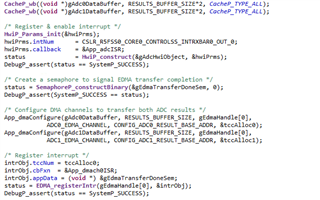

3) I tried to add EDMA channel to transfer the result, I use almost the same configuration as in example adc_soc_continuous_dma, however, it doesn't work. The destination buffer is never updated.
I checked the register TPCC0, it looks the value of edmaParam is written correctly.
I tried to create edmaParam1, edmaParam2 and call API to link these two parameters, still not work.
what is worse, if I use following code to resister an interrupt function of DMA, the software will enter an abort, where I can't locate where the software is blocked during debuging. Without this interrupt register, the software can run, with EPWM and ADC working but DMA not woking.
/* Register interrupt */
intrObj.tccNum = tccAlloc0;
intrObj.cbFxn = &App_dmach0ISR;
intrObj.appData = (void *) &gEdmaTransferDoneSem;
status = EDMA_registerIntr(gEdmaHandle[0], &intrObj);
DebugP_assert(status == SystemP_SUCCESS);

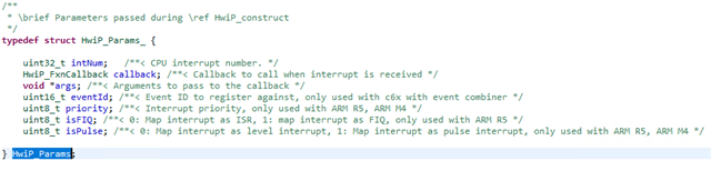

    3) Is it possible because of the conflict between several interrupts (adc_isr, dma_isr, RTI0) bringing the issue? Should I configure the priority of interrupts and how to make it through SysConfig?
    Yes for RTI timer interrupt priority, it can be set through syscfg.
    For other interrupts, you can use hwiPrms.priority parameter

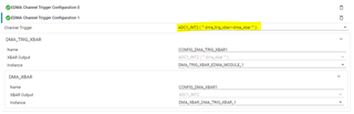

  • Hi Sri Vidya,
    Thanks a lot for your reply.
    Only one ADC interrupt ADC0 INT1 was enabled during the test.
    The trigger of DMA is ADC0_INT1 ( '''' dma_trig_xbar<-dma_xbar '''' )  in Syscfg.

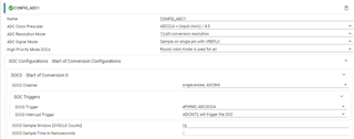

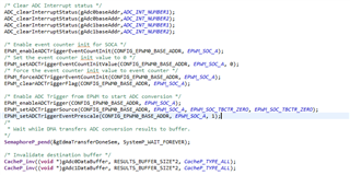

  • You can debug the issue by checking below configurations for ADC DMA:
    Initially check if the ADC DMA example that you have configured alone is working, without the timer interrupts (make the timer interrupts and other peripheral interrupts as lowest trigger priority - 15)
    1. check to see if the PWM --> triggering the ADC SOC in syscfg
    2. ADC EOC conversion interrupts need to be configured in the Syscfg
    3. These Interrupts are linked to DMA
    Cross check the DMA Xbar, DMA Trigger and INT Xbar configurations.
    4. check the DMA intialisation code:
    5. Check the ADC EPWM Trigger Code
    Hope this helps.

  • Hi Sri Vidya,
    I did similar modification on my side, and it did work as expected!
    Now I have new question:
    1)If I want to periodically trigger the DMA transfer and interrupt of transfer completion after EOC of ADC0, what should I do?  In the example adc_soc_continuous_dma, it looks the DMA transfer only performs once.
    I removed the disable functions in isr, now the ADC can sample periodcally. I confirmed it through toggling an GPIO(B&) in App_adcISR. however, when I try to toggle the GPIO in App_dmach0ISR, it doesn't woke.
    After I added following codes to link the DMA params, still not work:
    EDMA_setPaRAM(baseAddr, param0, &edmaParam1);
    EDMA_setPaRAM(baseAddr, param1, &edmaParam2);
    EDMA_linkChannel(baseAddr, param0, param1);
    EDMA_linkChannel(baseAddr, param1, param1);

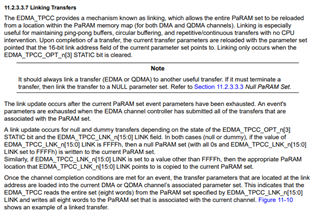

  • Hi Lync
    To perform recurring operations through DMA you will have to link the paRAM sets to itself. The example for EDMA through linking is already present in the SDK in this location:
    https://software-dl.ti.com/mcu-plus-sdk/esd/AM263X/latest/exports/docs/api_guide_am263x/EXAMPLES_DRIVERS_EDMA_LINK_TRANSFER.html
    You can use this as reference to modify your example.
    For more information, refer to the 11.2.3.3.7 Linking Transfers section in the TRM.
