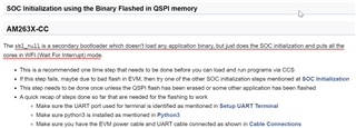

  • Hi ,
    Can you share more information on this...
    1. Which examples are you trying ?
    2. What is your boot mode setting ?
    3. Are you using the GEL scripts to initialize your system ?
    4. Can you try with SBL NULL and without loading the GEL Scripts ?
    Aakash

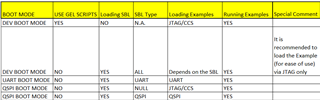

    Please follow the following cheat-sheet for the boot combination understanding -
    Anything outside this is very custom and might not be supported in SDK by default.
    Aakash

  • Hi ,
    Please checkout these details - https://software-dl.ti.com/mcu-plus-sdk/esd/AM263X/08_05_00_24/exports/docs/api_guide_am263x/ADDITIONAL_DETAILS_PAGE.html
    If you use GEL Scripts follow this method -
    If not, follow this -
    For more information on loading and unloading the gel scripts - https://software-dl.ti.com/ccs/esd/documents/users_guide/gel/files.html
    Aakash
  • NO BOOT mode resolved the issue.
