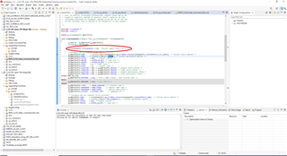

In this project, using linker script we generated CRC for the four sections of the code (i.e. intvecs, text, const and cinit) and stored their known CRC values in flash.
For Auto mode CRC verification i created two DMA channels, one channel is to move known CRC to the CRC value register and second DMA channel is to move the memory contents to PSA signature register to calculate the PSA signature value.
Here just mention the sector number for which you want to calculate the AUTO CRC

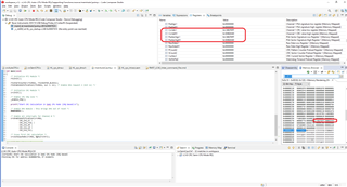

Once you mention the sector number you can verify in debug window the PSA register and CRC value registers with final CRC values.
Here i didn't create example for all the sectors at once because, here sector sizes are not uniform like as mentioned in TRM. That is why i created example for to calculate CRC for one sector at a time.
