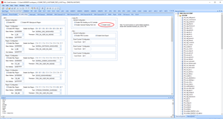

  • Hi Georg,
    Is cache enabled in your project?
    If yes, can you please test it by disabling it once?
    Thanks & regards,
    Jagadish.
