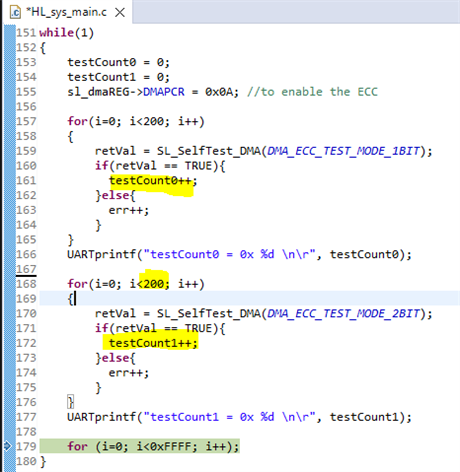

  • Hi Cameron,
    I did the same test on my launchpad. I haven't reproduced the issue:
    testCount0 is the number of total test, and testCount1 is the number of test whose error address is not correct (0xFFF80014).
    #define dmaBadECC        0xFFF80014u

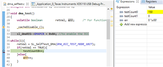

  • Hi Cameron,
    This is my test code for DMA ECC error injection:
    TMS570LC4357_DMA_SelfTest.zip

  • What I think I should have replied is that your code works works correctly every time when I run it with the CDT debugger in CCS, which appeared to be what you used to check that the DMAECCSBE address is correct (as in the image you've posted above).
    My project also works correctly with the debugger, but regardless of the build options I've tried (including no optimization) it still does not consistently report the correct address in DMAECCSBE when the build is run apart from the debugger.

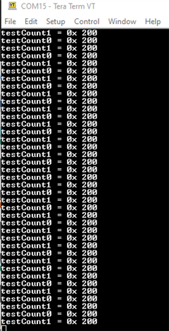

  • I am using TMS570LC43x Launchpad for this test. The launchpad is powered through the USB cable which is also used for XDS110 debugger and SCI.
    I run the test with debugger connected and debugger disconnected (power-on reset). I got the same test results.
    This is my test result:
    The first two rows: test with debugger connected
    The remaining (row #3 ~ row #8): test after power-on reset.

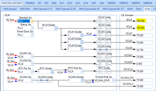

  • Hi again QJ,
    Is it possible that CPU Clock speed could be responsible for the difference in results we're seeing? Mine is configured at maximum speed. If yours is lower, could that account for the difference?

  • Hi Cameron,
    300MHz CPU clock is used in my example project. The maximum CPU clock for TMS570LC43x is 300MHz.
  • Hi QJ,
    Continuing with this theme, I compared the clock configurations in your TestSafeTI.hcg file with that in our .hcg file. In the GCM page in the TMS570LC4357ZWT tab, I noticed the following differences (our values in parentheses). Would any of these different values be relevant to the errors we're seeing? Thanks.
    HCLK divider = 2 (1)
    HCLK = 100.000 (150.000)
    VCLKA Src = VCLK (PLL2)
    VLCK1 = 50.000 (75.000)
    VLCK2 = 50.000 (75.000)
    VLCK3 = 12.500 (75.000)
    VLCKA = 50.000 (80.000)
    RTI1CLK = 50.000 (75.000)
    VCLKA4_DIV = 50.000 (75.000)
    VCLKA4_S = 50.000 (75.000)
    Oscillator = 16.0 (18.0)
    PLL2 = 300.0 (80.0)
  • Hi Cameron,
    I re-configured the HCLK to 150MHz, and all the test passed.
    testCount0 and testCount1: # of passed test
    # of total test is: 200
