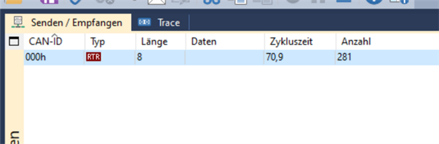

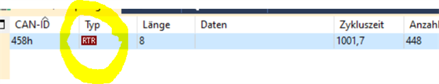

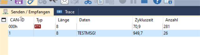

It is sending out Messages with ID 0x001. But I dont get the Idea of changing the CAN-ID for transmitting different Messages.
When I change the ID for example to 0x458 the CAN Anylyzer sees ID 0x000h and also the Message is empty/corrupt and the Cycletime repeats not with 1sek. It repetas a 000 message with 70ms.

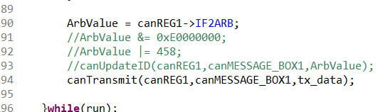

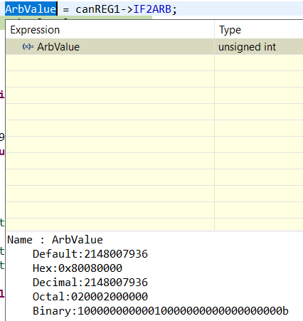

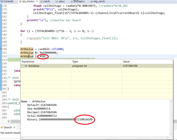

I found a hint , at the C2000 forum using a ID Message Update function.
https://e2e.ti.com/support/microcontrollers/c2000-microcontrollers-group/c2000/f/c2000-microcontrollers-forum/1082146/tms320f280025c-send-different-can-messages-with-only-id-change

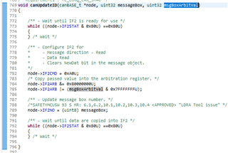

Therefore found "CanUpdateID()" at the CAN.c library.
But usind this function destroys someting. The message is empty and the CAN-ID is not 001 anymore, it is 000h

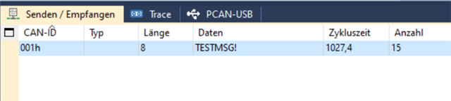

without canUpdateID()
The Cycletime is ~1sek as expected and the Message is there:
(CAN-ID 000h is not transmitted in this example code, it was only stored from the PCAN-View CAN montitoring software)
