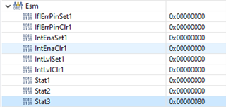

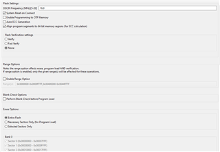

my debug settings are as follow:
I have the flash ECC check enabled in Halcogen, and when I try to flash the generated binary from the CCS, I have the ESM module triggering the nError output.
I tried by flashing it from Uniflash, it has the same behaviour.
I guess there is some mistake in my linker file? could you please provide some feedback regarding this?
