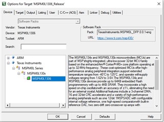

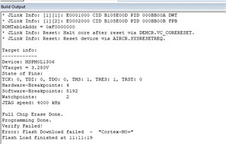

CMSIS-Pack Version 1.0.0 shows this failure message:

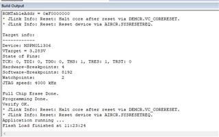

Version 0.0.1 doesn't show this issue:
Any explanation for this?

Hi Bernd,
Please see this FAQ Post for information on Early Sample Software version compatibility
Please use the CMSIS-PACK from the MySecureSoftware folder for early samples. I believe this only goes up to 0.0.1. Version 1.0.0 should be for production devices.

Hi Bernd,
I can't replicate it on our side, at least with my setup.
Does the customer see this issue just with a regular example? If they can only replicate with their binaries, would it be possible to share them and/or provide a description of the memory map?
Are they programming NONMAIN?
Which programmer are they using? If using Segger, which version?
And, is the configuration of the memory looking OK?

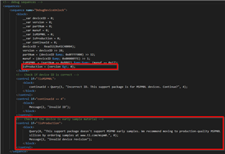

I assume that the customer tried to program RevA with CMSIS-Pack v1.0.0.
1. Does the software check the DEVICEID register?
2. Does RevA just run with CMSIS-Pack v0.0.1 and RevB just with CMSIS-Pack v1.0.0 ?
Please let me know and I let the customer check on his side.

Hi Bernd,
Yes it does check the device ID register. I haven't used this software myself, so I'll let Luis comment on if it will stop you from programming, but at a minimum CMSIS-Pack version 1.0.0 seems to indicate it should be throwing device revision errors when they attempt to program, see below:

Hi Bernd,
That is correct. The public CMSIS-Pack 1.0.0 only works with production silicon. Customers using early silicon should continue using the pack from MySecResources.
More details in this FAQ:
