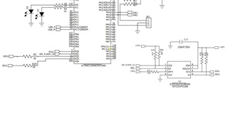

TM4C1294NCPDT: TM4C1294NCPDT
Part Number: TM4C1294NCPDT
I'm trying to use SPI communication between TM4C1294NCPDT and SST25VF016B.  Slave device MISO (SDI1)(SPI Flash  SST25VF016B )is not responding .
Please refer the enclosed code , circuit  and  help to resolve the issue.
Thank you.

#define SCK1  GPIO_PIN_0
#define CS    GPIO_PIN_1
#define SDO0  GPIO_PIN_2
#define SDI0  GPIO_PIN_3
uint32_t g_ui32SysClock;
static uint8_t SPI1_Initialized = 0;
// Pin Configurations
// Initialize chip select as Output
//#define INIT_CS()       ((MAP_SysCtlPeripheralEnable(SYSCTL_PERIPH_GPIOQ))\
//                          (MAP_SysCtlPeripheralEnable(SYSCTL_PERIPH_SSI3))\
//                          (MAP_GPIOPinTypeGPIOOutput(GPIO_PORTQ_BASE, GPIO_PIN_1)))
#define SDSPICSAssert()      (MAP_GPIOPinWrite(GPIO_PORTQ_BASE, GPIO_PIN_1,0))  //(LATBCLR = (unsigned int)(BIT_15))
#define SDSPICSDeAssert()    (MAP_GPIOPinWrite(GPIO_PORTQ_BASE, GPIO_PIN_1,2))  //(LATBSET = (unsigned int)(BIT_15))
#define SST25_WRITE_BYTE(X)  (SPI1_WriteByte((X)))
#define SST25_READ_BYTE()    (SPI1_ReadByte())
#define SST25_WRITE_BYTE(X)      (MAP_SSIDataPut(SSI3_BASE,X))
#define SST25_READ_BYTE(X)       (X=MAP_SSIDataGetNonBlocking(SSI3_BASE,X))//SPI1_ReadByte()

        MAP_GPIOPinConfigure(GPIO_PQ0_SSI3CLK);
        MAP_GPIOPinConfigure(GPIO_PQ1_SSI3FSS);
        MAP_GPIOPinConfigure(GPIO_PQ2_SSI3XDAT0); //tx
        MAP_GPIOPinConfigure(GPIO_PQ3_SSI3XDAT1); //rx
        MAP_SSIConfigSetExpClk( SSI3_BASE,  MAP_SysCtlClockGet(), SSI_FRF_MOTO_MODE_0,
                                    SSI_MODE_MASTER,
                                    (100000),
                                        8);
       SSIAdvModeSet(SSI3_BASE, SSI_ADV_MODE_READ_WRITE);//SSI_ADV_MODE_QUAD_WRITE);//SSI_ADV_MODE_READ_WRITE);//SSI_ADV_MODE_QUAD_WRITE);
      // MAP_SSIAdvFrameHoldEnable(SSI3_BASE);
       MAP_GPIOPinTypeSSI(GPIO_PORTQ_BASE,  GPIO_PIN_0 |GPIO_PIN_2 | GPIO_PIN_3 );
        MAP_SysCtlPeripheralEnable(SYSCTL_PERIPH_SSI3);
        MAP_SSIEnable(SSI3_BASE);
        SPI1_Initialized = 1;

      You have the below line which is wrong. You cannot call MAP_SysCtlClockGet() as this API is only for TM4C123 MCU, not for TM4C129.
     You need to change to
    MAP_SSIConfigSetExpClk( SSI3_BASE, g_ui32SysClock, SSI_FRF_MOTO_MODE_0,
    Thanks for quick support.
    Suggested modifications done, but flash is not responding.
      I will suggest you use the scope or logic analyzer to first see if you have the right command come out of the SPI port. Do you meet your flash's timing requirements? Does the master send the right command sequence that is required by the flash? What does the flash return on its SO pin? If the master sends the right command but the slave doesn't return the right data then you will need to investigate the slave. You will have to do this level debugging on your own. If the master doesn't send the right command then you can focus on the software.
      I have not heard back from you. Do you have any update?
      I have not heard back from you. Earlier I suggested you to use a logic analyzer to capture the waveforms to/from the flash. Did you have a chance for that? I will close this thread for now. If you have any update, just write back to the post and the status will change to open. I will be notified.
