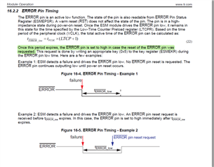

TMS570LC4357: Clarification the ERROR pin behavior for ESM group 2 and 3
Part Number: TMS570LC4357
Hi *
For ESM group2 and ESM group 3, when the errors condition happened, the TRM 16.1.1 mentioned that predefined ERROR pin behavior.
Could someone help me out on this part, what is this expected output behaviour, is there a fixed value that is mentioned in the TRM or datasheet?
