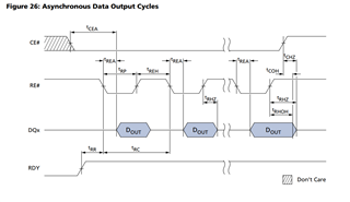

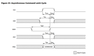

Hi, I want to interface NAND flash memory(MT29F64G08AFAAAWP-ITZ:A TR) to TMDS570LS31HDK Hercules TMS570LS31x/21x Development Kit.

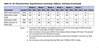

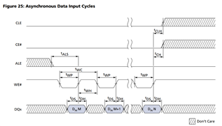

The Problem is while writing 8000 bytes of data continuously some data is missing in between.
GPO pins are used for ALE(GPOA  7), CLE(GPOA   5).
*Note: For chip select  I am  using EMIF's nDQM pin instead of EMIF 's nCS2 pin. Because of Multiple Write pulse while writing single byte data.

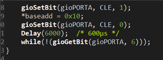

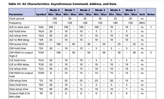

If I run the above code, it write data in NAND flash memory. But here two problem  occurs
First one is some data is missing while writing 45 data.
Second one is If I want to increase the data length from 45 to 100 or 1000 or 8000, It can't write. While reading it give's 0xFF for all data.

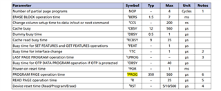

so after I put delay in between every data the second problem is solved but I don't know how it works.
But still the First problem is not solved.

  • The EMIF on TMS570 supports an asynchronous interface with dedicated signals that is compatible with typical NOR flash and SRAM.
    The EMIF on TMS570 device doesn't have Ready/busy# (R/B#) signal. If the NAND Flash device is busy with an ERASE, PROGRAM, or READ operation, the R/B# signal is asserted LOW. The NAND protocol is not natively supported by TMS570.
    You may try EMIF EMIF_nWAIT to interface NAND R/B# signal. The R/B# signal is open drain and requires a pull-up resistor.
